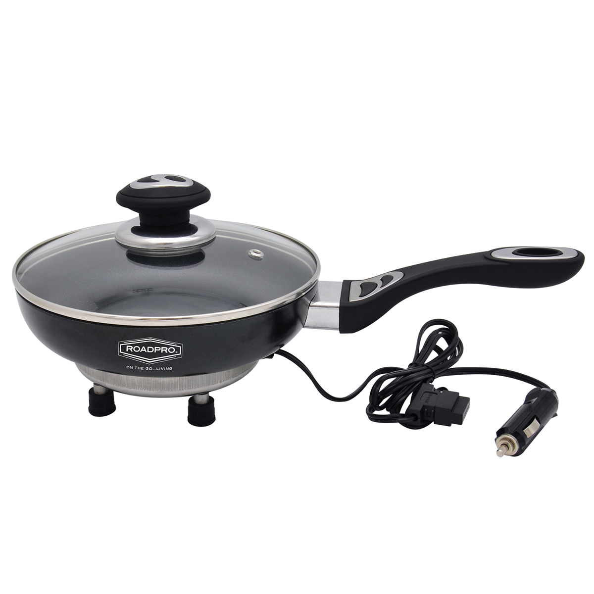

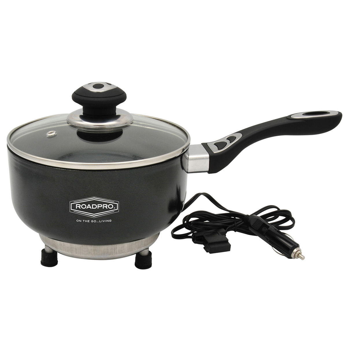

RoadPro makes 12V powered cooking appliances for truckers. I bought one, but haven't had a chance to try it yet.
This is the one I bought. Seemed like the most useful of the items they sell.
If it works well, I might get the frying pan. Ham and eggs!

Good luck frying an egg with 180 watts.
You just need insulating cover for the frying pan and half an hour to preheat it. :p

I don't doubt it, but people shouldn't think they can have a normative cooking with something like that frying pan.
