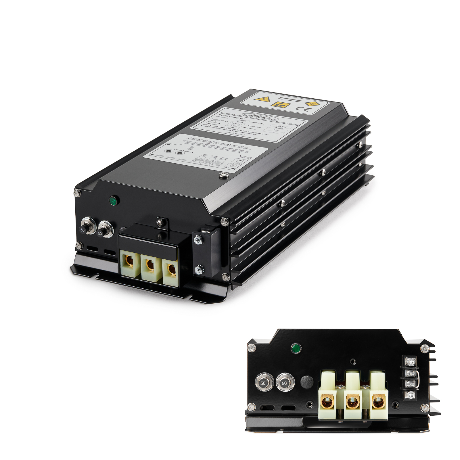

Yes, but I would be concerned about the cost of a 850W / 12V / .8 = 89A 24V-12V converter.
Do you already have the 12V A/C? IMHO, the cost associated with DC appliances is rarely worth the small efficiency savings vs. AC powered appliances.
Yup, AC is already there as well. Which 24-12 converter could that be? Hopefully it’ll be capable of handling air conditioning plus any other 12v needs which should be marginal.
I appreciate your help.
This DC - DC converter can support up to 60 amps.
These guys make really rugged products, so they tend to be a bit more expensive. No tariffs since made in USA.

Pretty good specs!
Yes - and I have direct experience with them in mobile applications.
They originally were focused on the mil / telecom market, but have expanded over time.
You can put their stuff on a telephone pole in the middle of Alaska and not worry. ( the sealed units )
