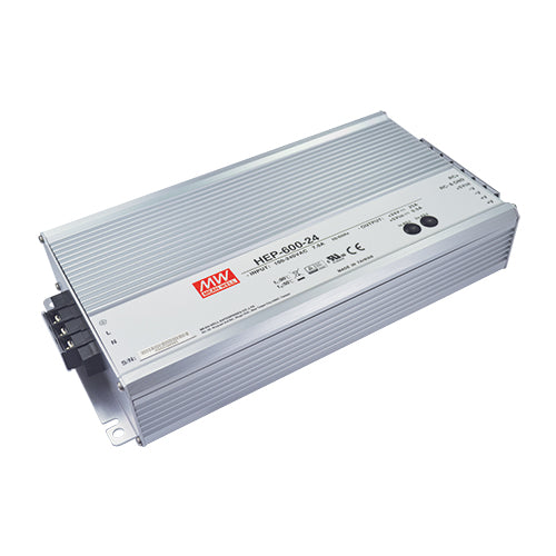

For the top end in quality and absolute silence with passive cooling the Meanwell HEP power supplies have been used successfully, two of these HEP-600-54s will get you 22.4A but at a price...
Damn, you're right when you say "at a price!"
I've tried THREE of these. now. They work for a while, then not. I have one that is putting out the set voltage at no load, but, delivers no current. The other only is putting out a maximum of about 8 AMPs.
Amazon: 60V 25A 1500W DC Switching Power Supply Adapter PSU AC 110V / 220V-DC 60V
That said, I'm seeing a bunch info that general purpose power supplies are not a good idea for charging batteries and that a purpose-built charger is. a better way to go.
For the price of two of the above, I'm probably best off with a purpose-built charger, no?
Yes generally these are used to float the bank at say 54V etc overnight till sun picks up in the morning etc, not to fully charge a battery. There are two adjustment dials to adjust voltage and current.
Some also use 48V rectifiers from telecoms equipment etc which can be found quite cheap on ebay etc, some diy work involved there.

The EU2000i generator is good for 1600W continuous, or . The power draw of the 25A power supplies that I was trying was about 13A, which is about 1600W. At least with this power supply the generator was definitely up to task.
A lot of those golf-cart chargers are made for lead-acid batteries. The one that came with my mower is 13A and looks identical to the 13A ones I've seen online.
