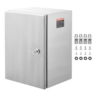

Use one or two of this kind of box back to back, would allow you to build one with common inexpensive AOI and battery .. or Victron or maybe low budget and the Victron version ..

Me thinks to make it waterproof, you have to put it in a sealed box. The box would then have to be metal and serve as the heatsink.
Oh, for sure.
However, rain protected should suffice for a portable power unit.
There are a few inverters rated as IP65 which would make them "showerproof".
Our Deye units are, sealed and no external fans (one assumes those from that other company follow suit). :)
That said, I have some "IP65" floodlights that are half full of water :(
