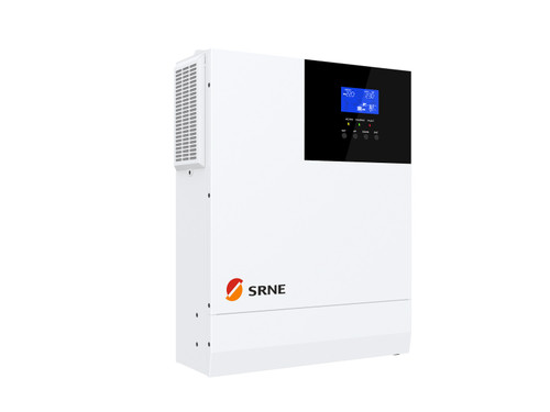

$764 for 5kW 120V sungoldpower inverter. Out of stock everywhere else.
Will Prowse
Forum Owner
Staff member
Moderator
Sep 19, 2019
5,415
36° N 116° W
Out of stock with every distributor on amazon.com.
But there seems to be some inventory left on their main site (affiliate link):
https://shrsl.com/4wy7f
Still running it in my work shop with 5kW of solar. Half the carport, 12X aptos panels. Working great, even in 120 degrees. Can't wait to make my update video.
In early July they should have inventory on amazon again.
Check out my current production. Daily and total:
And the temperature it's running at here in Las vegas. It's in my super hot metal building:
Also, the display rocks. Other companies could learn from them.
Downside is that there are way too many settings. It takes forever to click through it all. Cycling every day and running loads. Love it.
The EG4 one is reliable as well. Both made by SRNE. Hope the other models sold on market get this screen.
Show me a broken SRNE inverter thread here on the forum. It's crazy how good they are
There are a couple that I've seen, a failed ASF and different model I can't remember; I'm to lazy to search for them at the moment. I know one member posted SRNE support worked with them swapping parts and eventually replaced the unit, that was a while ago.
Their support reports have been mixed. I haven't had any issues with them replying, there is a delay at times. I haven't needed any support for major issues, just clarifying on logic and settings.
I hope to see more members run their HEBP, it looks very promising; I consider it direct competition for the favorite hybrid grid interactives on the forum.
I think the Eco Worthy Hybrid is the same SRNE clone.
Connections and screen look quite similar:
I have one. A solid inverter. Any automation based on the SRNE protocol (if properly implemented) will work. Solar Assistant works well with this inverter.
