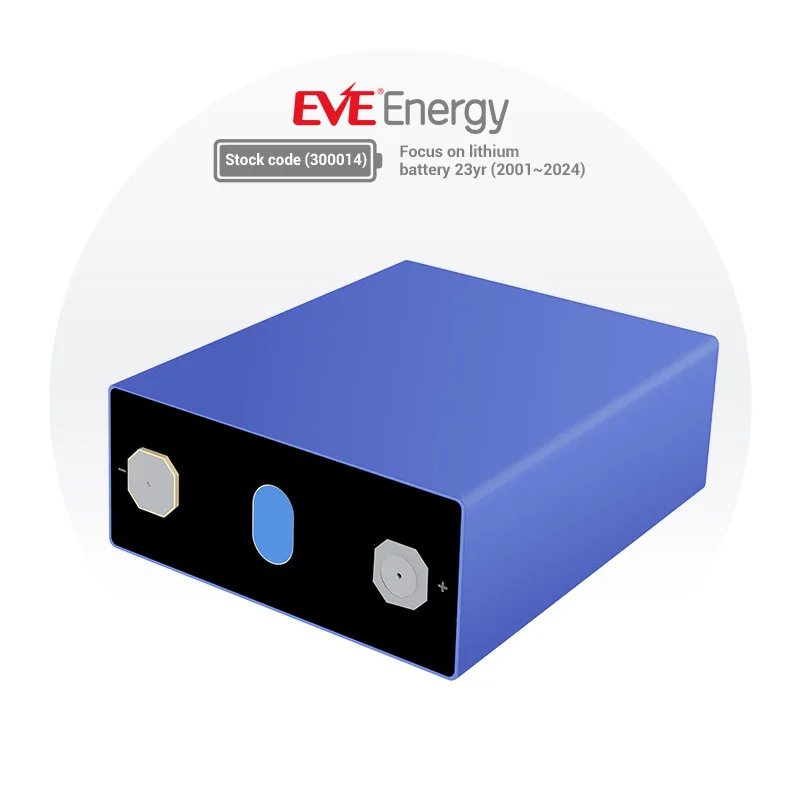

The battery I'm currently brainstorming with is the EVE MB30. https://www.alibaba.com/product-det...fferlist.topad_classic.d_title.87aa458eANU1mh

Really?? Mostly surprised that single, unboxed, unconnected, Eve prismatic cells would be UL listed.
According to the EVE's official alibaba page they're UL listed. The 5th picture has a UL certification. The image is a bit blurry, so maybe they're just lying about it, but they're a huge manufacturer, not some random company, so idk.
Edit:
Found the official UL listing. MB 30 is one of the model numbers.
The cells themselves are UL listed, as is often the case with some preassembled batteries as well.
They are not UL9540/UL9540A which is what's required to be used as batteries in a grid tied UL approved inverter/battery combo.
Edit:
I don't see how a single cell can be UL Listed
Or if they are, that it means much of anything at all.
From Alibaba link, UL: "Module Test Report - Method for Evaluating Thermal Runaway Fire Propagation in ESS"
Doesn't sound like a cell to me.
The cell by itself is easy to make bloat and vent flammable gasses. Whether it is safe has to do with the charging and BMS circuits.
Can't test fire propagation for a single cell.
