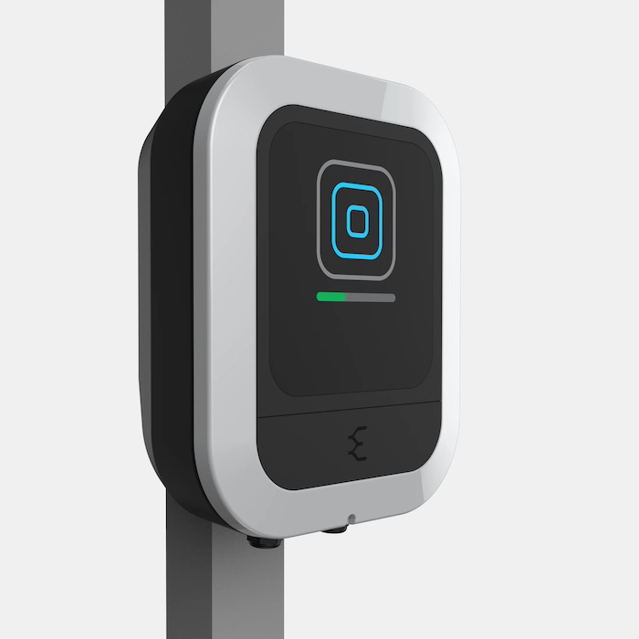

Back in May 2024 Entelligent announced and started taking pre-orders for a direct solar DC-DC EV charger for up to about 12.5kW the TCLEV T1 EV charger. Just add panels!
It would be ideal for your purposes and the target price was an affordable 2,500 USD.
Unfortunately, the link to pre-order is now dead and the Entelligent site now only has a much larger commercial level charger :(
Evidently the market was just too niche :(
Others are offering "Solar EV chargers" but these all are intended to integrate with an existing domestic solar power system although at least one does promise DC-DC charging.
