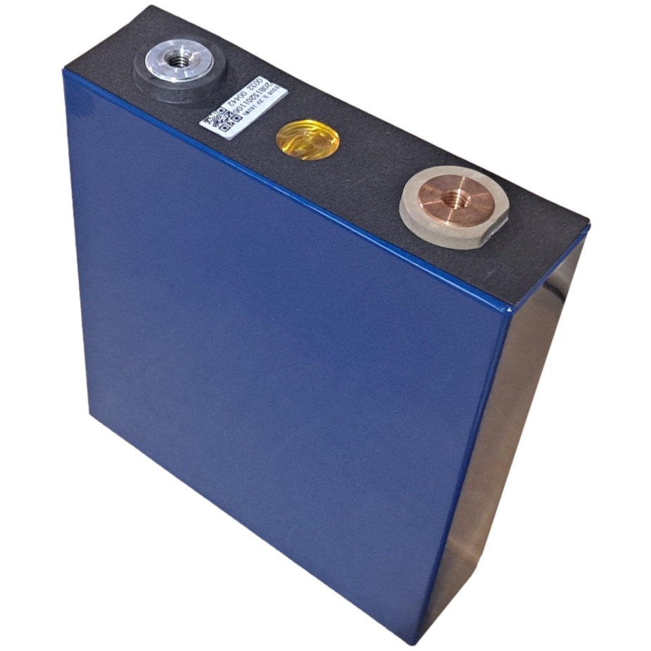

Battery hookup has some Envision 280ah cells I was thinking about adding to my bank of 314ah just because of price . Is this a legit business for quality cells? Also has anyone mixed Envision cells to an existing bank of EVE cells?

I have 5 envision packs and 1 EVE pack. The charging characteristics of the EVE are slightly different. Depending on the size of your system, I would want at least 2 of each.

I'm running Envision 305Ah, EVE 230Ah and REPT 280Ah.
