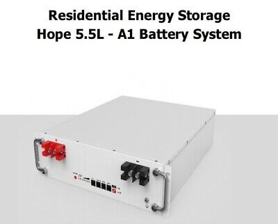

My current thinking on my Off Grid Solar Install in Australia. The Growatt 3000TL HVM-48 is a Controller/Charger/Inverter in one box, if the battery get low, its charged off the mains to keep the frig etc going. Weakness I understand, is it can be noisy on full load and it will be adjacent to a spare bedroom.
Appreciate comments either on the Forum or via a PM. Thanks

Growatt 48v 4.8Kw Battery

Only comment I have is the battery is a 48 V spec (presumably a 15S LiFePO4 cell arrangement) rather than the more common 51.2 V spec (16S cell arrangement). That's fine, just keep in mind one of the things we all tend to do is expand storage capacity and so you'll need to make sure you choose the same voltage configuration if adding on more later.

Thanks for your reply, re the Growatt 48V Lithium Battery, I originally intended to use a Pylontech 3000 battery which I understand are a lot more commonly used in Australia but was told and have read about comms/warranty problems so went with the little known Growatt 48v battery to match the Growatt Inverter, so in theory no buck passing if any probs.( and both purchased from the same supplier)
