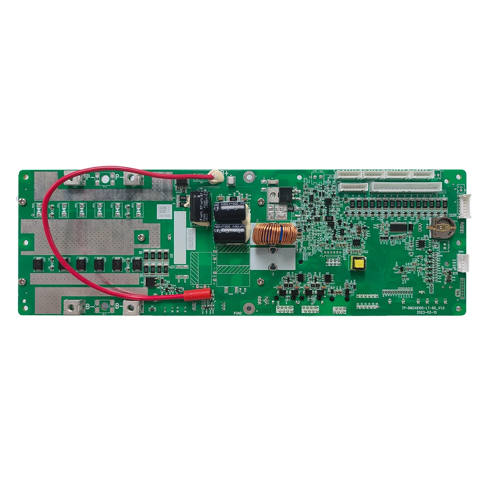

I swapped BMS and the problem persists.
I isolated it to the PCB1 rail.
I wonder if I can just run a straight wires for those two wires - 5,6
So in the password box, you enter either 666666 or 888888 (no enter) depending on the page. As soon as it accepts the password, you should see the fields you can change. Click on the field on the left of the screen then on the right it will show you the modify box. Change the value and hit "write". You can change anything in the Alarms and Protection screens under the Info tab.
Well... That resolved my issue, i was able to change parameters using the 666666 password. I never thought the password on one settings screen would be 888888 and then on a different screen be 666666, but that is what is going on WTH :mad::mad::mad:
I still have the issue that I cannot have more than 10 packs connected in parallel. I can have 0-9 and it all talks fine to the EG4 Flexboss, as soon as I add one more, I get the red battery indicator and W000 error (communication loss)
I ran a continuity test and it seems I have an open circuit for pin 5,6. This PCB came wrapped tightly in plastic sheets. All other PCBs weren't wrapped.
OK there you go. Let them know of the defect obviously, but you can just solder extensions to salvage this one I would think.

So the I believe the BMS is NOT TitanPower but it IS TianPower indeed.
Trying to find out what is the brand of the 2A Active Balancer though...
