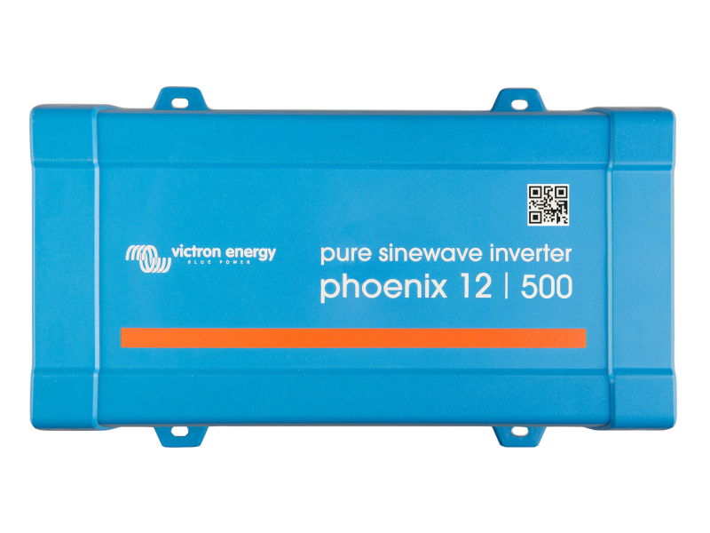

Inverters.
All inverters take a standby current, even with no AC load. The lower the quality and the higher the power rating, the greater the standby current. You seem to have an low cost 4000 watt inverter. My guess this power is not needed and a lower power unit would be adequate. A further comment is that 16mm2 cable is unsuitable for a 4000 watt inverter.
Recommendations.
I have a good idea of your power requirements and suggest the following equipment. I will add circuit diagram later. I will give links to UK suppliers, you may find better deals or alternatives shopping around.
Inverter. Here for safety I recommend only the best. You have a low power requirement for AC power so 500 watts should be more than enough,

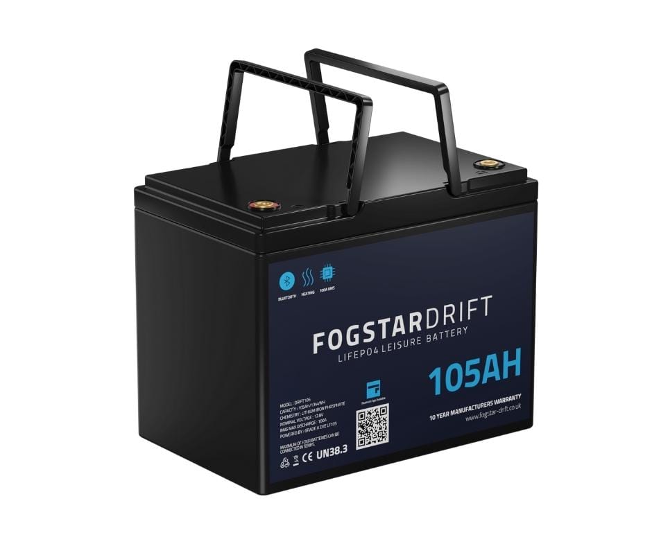

Batteries .
It seems you are limited, inthe main, to solar for charging.
Ideal would be lithiun, no worries about under charge, fast charge from solar , long life. At the price the fogstar batteries are lower cost than quality lead, 230 or 280 Ah

Dumping the inverter and using 12v chargers for charging laptop may save energy. Only use manufactures 12v chargers for laptops, the low cost stuff may damage your computer. Using a quality low power inverter, even as low as 250 watts, with manufactures mains chargers is an option.

As has been mentioned, LiFePO4 may be attractive. It has 5x the cycle life and can charge at 0.5C, also is not harmed by low SoC. For modest loads like this system, the one significant issue is not charging below freezing.

Inverters.

Lithium batteries.
In the UK there are a limited number of outlets and two relatively small companies have excellent customer support,
Since Fogstar batteries are by far the best cost per Ah even competing with the quality lead, this is what I would recommend. Although ideally you want as much capacity as is reasonable, 200 to 300Ah for your modest use, even a 100Ah would be practical with careful management of power use.
Consider the maximum current output of the battery if you are intending to have a high power inverter.
