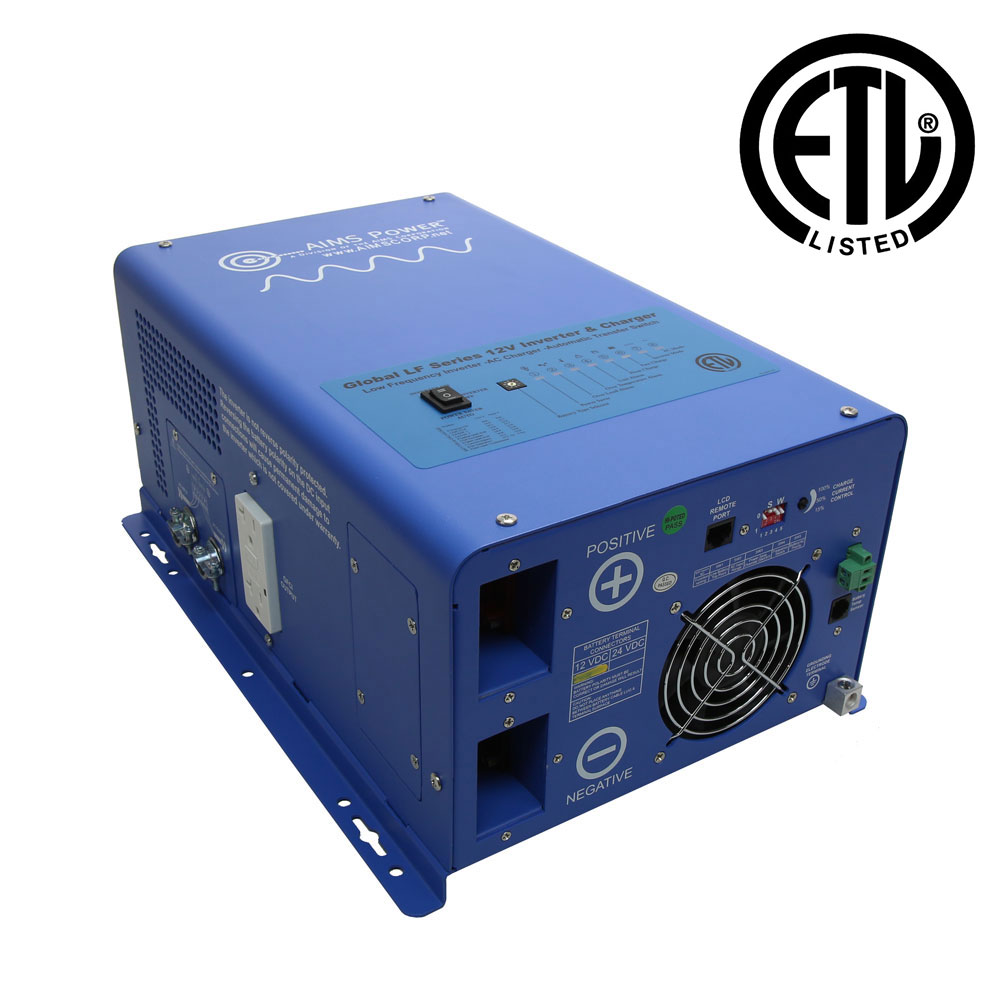

Again, the inverter is a couple months away; but, I was liking a couple of the " AIMS. What do you think about that one?
