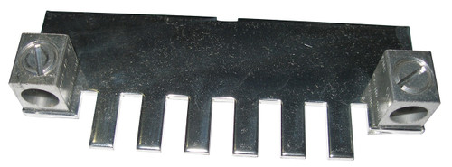

Ideally you'd have an mnpv6 combiner enclosure like this.
But its expensive. So you can just get the breakers and the busbar that will connect to the top of the breakers.
Get four of these:
And one of these:
Note these breakers are 10A, based on your 7A string currents. Your 30A dc breakers will never fulfill any ocp functionality.
Attach the breakers to a din rail from a vendor of your choice. Run your home run from the bus bar back to the scc. Could use something like this for the negatives:
You have per string disconnect and ocp with these breakers. Note they have 1PNP at the end of their model name which designates non polarized.
May want to consider adding an spd300 when funds permit for surge protection.
This is assuming your string voltage is below 150V if not you'll need different breakers.
