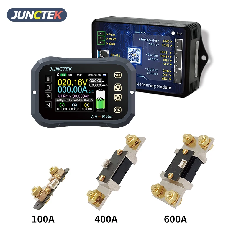

Hello everyone! We are JUNCTEK.
Professional manufacturer of battery monitors
Our product calculates the remaining capacity of the battery according to the charging and discharging current * working time, which is very accurate and provides Bluetooth control of the mobile phone APP.
Today I bring you a discount for the new battery monitor KG-F series products
For the top 5 friends in the forum, we will give you a 50% discount.
For the top 10 friends in the forum, we will give you a 30% discount.
When placing an order, submit the order first without paying, our customer service will adjust the price for you.
Below is the link to the product,

Model
KG105F​
KG110F​
KG140F​
KG160F​
KG610F​
Sampling method
The Shunt​
The Shunt​
The Shunt​
The Shunt​
The Shunt​
Voltage measurement range
(External power supply)
0-120V​
0-120V​
0-120V​
0-120V​
0-600V​
(Self-powered)
10-120V​
10-120V​
10-120V​
10-120V​
10-120V​
Voltage resolution
0.01V​
0.01V​
0.01V​
0.01V​
0.01A​
Current measurement range
0~50A​
0~100A​
0~400A​
0~600A​
0~100A​
Current resolution
0.01A​
0.01A​
0.1A​
0.1A​
0.01A​
Relay
Optional​
Temperature measurement range
-20-120℃​
Capacity display range
0%~100%​
Power measurement range
0~180KW​
Power resolution
0.01W​
AH measurement range
0~9999.99AH​
Capacity resolution
0.001AH​
Watt-hour measurement range
0~9999.99kWH​
Watt-hour accuracy
0.001WH​
Time measurement range
0~999:59:59S​
Time resolution
1 second​
Bluetooth communication distance
10m​
Voltage accuracy
±2%+3 digits​
Current accuracy
±5%+10 digits​
Sampling rate
1 time / second​
Measuring module
power consumption
About 0.4W​
Display module power consumption
About 0.5W​
Over power protection
0-99999.99W​
Negative over current protection
0~50A/100A/400A/600A​
Forward over current protection
Over voltage protection
0~120V/600V​
Under voltage protection
0~120V/600V​
External over temperature protection
0-120℃​
Protection recovery time
0-99s​
Enter standby time
0-60s​
Delay time setting
0-99S​
Communication address
There are 99 P01-P99, P00 is the broadcast address​

@kang lee your software for the VAT1200 shunts introduced an error where the shunts count down into negative AH drawn when charging. Can you confirm if these new shunts have the same error or do they stop counting down when they reach zero?
kang lee
Sep 17, 2021
42
For vat1200, there is a - sign in front of the current during charging, but the capacity increases under charging state. This design is not very friendly. We have corrected this problem;
The current color of the new KG-F series is green when charging, the capacity increases, and the current color is sky blue when discharging, and the capacity decreases. Please rest assured.

Received. First impressions: Looks nice
First reactions:
Shunt could have improvements
- Only 1 label: GND. That does mean BATT. Would be much clearer if the GND port was labelled BATT and the other port LOAD.
- No mounting options. It would be nice if it was easier to mount without messing with cable ties, just like eg the Victron shunt
As for the app (I'm using IOS): Manual is not very clear.
First page has a proper link to the IOS store
Page 14 however has a non-working QR code (404 error) and 'search for KG series'.
However: the app is KG Serials... (so manual is wrong)
If the links and QR codes were at least all working that would be nice. Also how the f*ck do you find the app without those links in the manual? Why having a completely different app name and not include eg Junctek in the app name
Once installed (IOS app, iPhone SE 2020, IOS 15.0.2) I press search, find one (presumably the device), connect and the app just crashes.
Same applies to an old ipad (Air, running IOS 12.5.4)
kang lee
Sep 17, 2021
42
Regarding this issue, we will add the BATT and LOAD signs in the next batch of PCBs
Regarding this issue, we will add accessories to fix the 400A-600A shunt so that everyone can install the shunt.
Regarding this issue, we will add the keywords of KG series and JUNCTEK as soon as possible to make it easier for everyone to search for the program.
The QR code on page 14 is not the QR code for downloading the program, but a video on how to install and use the program. Our video will be updated within a week.
Regarding the crash of the ios15 program, can you send the video to my mailbox if it is convenient? lee@junteks.com, in addition, our programmers have already started to update this program, it can be processed in 3-5 working days
Thanks for your feedback, great suggestion!
