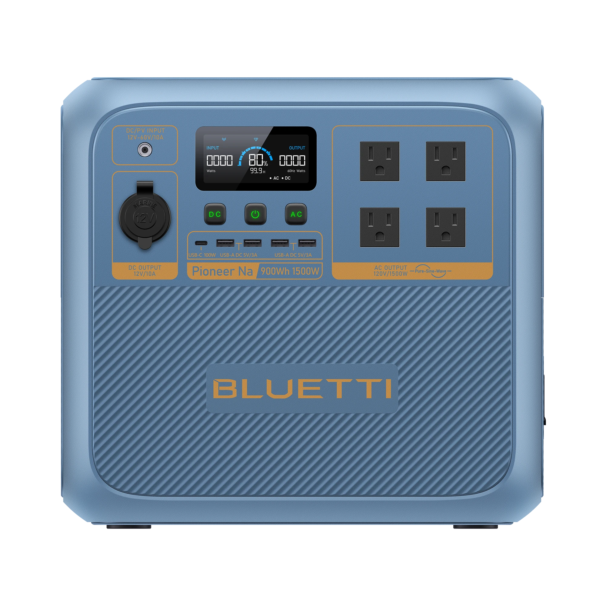

The sodium station is 900WH and can withstand lower temperatures than an LFP system, but not by all that much imho. It weighs 35lb vs their 1024WH LFP station that weighs 25lb. The fridge thing is like their regular 2KWH station but has a flat profile for placement next to a fridge, or maybe on top of it. Availability in a month or so, prices not yet announced.
It would be interesting to see the charging curve. My understanding is that sodium batteries have a much wider operating voltage range from fully charged to fully discharged, such that the necessary chargers are quite different (and, might be incompatible with present Li chargers).
(Of course the power station should have its own charger.)

$799, 900WH capacity, 1500W max power out, 35 lb weight. Worse in every regard than the Elite 100v2 except for the low temperature aspect. Oh yes the idle power consumption is quite low. I wonder if they can replicate that in future LFP models.
