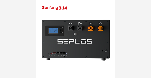

If you want the easy way of doing it I can recommend the Seplos Mason Kits. Everything needed to properly assemble your cells is included and are reasonably priced factory direct. Have built three of these in the last few months with great success. They offer the kits in both 24v and 48v.
The Luyuan thread got me into looking at kits/cases.
Remember though they were primarily known for selling quality cells a good prices, then they started offering semi customizable cases.
Jot down what you want AH size AH count and BMS peak current and they can put together a quote, you pay then wait 2-3 months and lots of boxes arrive.
