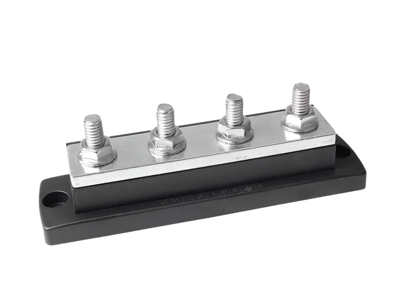

Hi,
I'm currently selecting the components for my electrical solar powered system in my Peugeot Boxer van conversion.
And I need some help with the cable and fuse selection, because different calculators give me vastly different results.
These are the parts I already selected and bought (solar panels will be figured out later):
  • 4 x LiTime 12V 100Ah LiFePO4 battery
  • 250A battery switch
  • Renogy 500A shunt
  • Blue sea MRBF fuse block (5196)
  • Giandel 2000W 230V inverter
  • Renogy 50A DC-DC charger with MPPT
  • Generic blade fuse holder
Since the inverter is 2000W I calculated that it could pull up to 167A. With a 25% safety that is 200A.
Do I need to use 70mm² wire and a 200A fuse for the connection from the fuse block to the inverter?
I guesstimated a total draw of max 250A with the other 12V loads (lights, fridge, heater, ...). Is that realistic?
Does that mean I need to put a 250A fuse and use 3/0 wire to connect the batteries together and from the batteries to the fuse block, since that's the smallest wire size I can use a 250A fuse with according to this chart?
Can I get away with smaller cable sizes because they are all very short runs (30-50cm/ 1-2ft max) or is the wire size really dictated by the fuses I need to use to keep my cables from melting?
Also will a 250A Busbar do to connect my negatives?

Use a Class T fuse at each battery pos(+), and connect from there to the busbars.
Then you can use 150A cabling from batteries to terminal block: easier to manipulate, and less expensive.
SCC outputs (you didn’t mention?) should connect to busbars, DC2DC charger connects to the busbars, 12V blusea fusebox connects to the busbars…and the 2000W inverter feeds from the busbars.
All with appropriate sized wiring and fuses rated at or less than the wire ratings.
“I” would use 2/0 to your inverter- wire will never get hot- and a 175A or 200A ANL fuse on the pos(+) to the inverter.
Would that mean I need a + Busbar with 4 connections for the batteries on top of the 3 for the DC-DC charger, inverter and blade fuse box (so a total of 7)?
Or is it ok to put multiple cables on one connection?

Use suitable rated buss bars for the battery parallel connections, look for copper , not brass, and studs they accept 8mm terminations, example,
avoid those busbars.
They are brass and will waste watts, and heat up under loads
I understand that you are technically correct and I believe it’s best case to go copper.
Nevertheless, with lots of respect for you, I’ve been using those successfully for over three years now; I know they’re not pure copper and not ‘ideal.’ on my 12V, 5kWh batts, 2kW inverter system I have felt them warming a couple of times (using table saw) but they never have gotten hot, nowhere near too hot to touch, maybe 100*F-ish
Whatever losses I may have are not noticeable in practical usage. Even with only 2000W of panels. Several years ago I ohmed the cables/circuits and laboriously (for me anyways) calculated the loss over the circuits through those busbars (and my crimps).
The percentage of loss was decimal.
It works.

But can I connect 2 wires to one single pole on the busbar?
Since I have 4 batteries, I need to connect 5 cables to the battery busbar. So can I get away with a 4pole busbar where I connect 2 cables to 1 pole or do I need to get a 6 pole one (5 pole busbars don't seem to be a thing)?
EDIT: I came across these Daiertek busbars on aliexpress. They claim to be copper and seem decent quality. Does anyone have any experience with these?
Use the aR rated NH fuses, they have a time current curve similar to the class T fuses. The NH fuses come from 00 through 03 sizes. The nh03 is a lot larger than the nh00 of the same amperage. The larger fuse bodies have higher AIC.
Marinco 600;amp 5/post with excellent cover.. I have several for busbars. Amazon ..about 100 bucks…could not ask for more
Yes
I have batt A neg on the bottom and batt A pos on top. That way they are “the same” resistance.
The inverter sits right on the busbar, an SCC can go on top of that. (SCC is likely far less amps)
