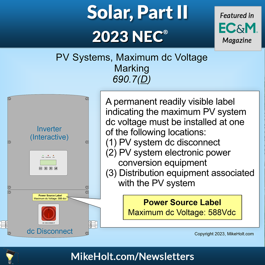

"2011 NEC requires series arc-fault protection in PV installations on or penetrating a building above 80 V"
Seemed to include wires on building coming from ground mount array, but this one (2023 so current) clarifies not if in metal conduit:
"PV system dc circuits, on or in a building, operating at 80 Vdc or greater must be protected by a listed PV arc-fault circuit interrupter or other component listed to provide equivalent protection [690.11].
Arc fault protection is not required for PV system dc circuits in metal raceways, metal-clad cables, enclosed metal cable trays, or underground if they meet either exception condition in 690.11 Exception."

It appears my case does not require rapid shutdown at the DC string wire home entry as per the Mike Holt forum post you listed.
description:
Two exceptions to the mandatory rapid shutdown function exist:
Ex 1: A rapid shutdown function is not required for ground-mounted PV system conductors that enter buildings whose sole purpose is to house PV system equipment.
Ex 2: PV equipment and circuits installed on nonenclosed detached structures including, but not limited to, parking shade structures, carports, solar trellises, and similar structures are not required to comply with the rapid shutdown requirements of 690.12.
A building with a rapid shutdown function must have a permanent label indicating the location of all rapid shutdown initiation devices. It must be near the service equipment or at an approved readily visible location [690.12(D)] and meet the specifications of 690.12.
thoughts appreciated
