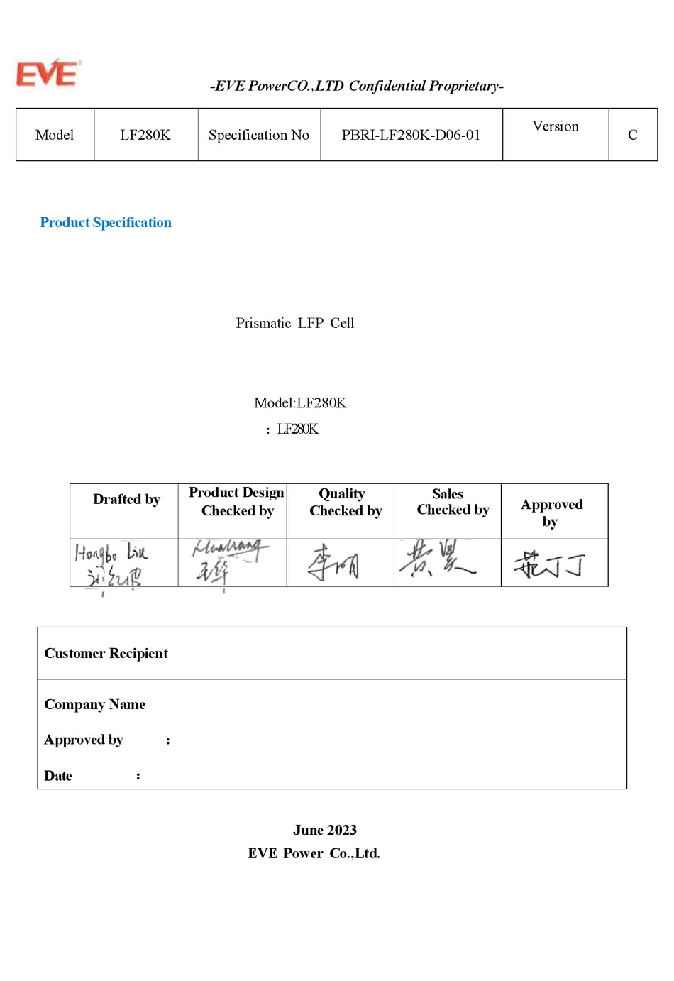

Couldn’t find much of anything online about this brand. Amazing deal for a plug and play battery though at $2700 Canadian for 15kw and they have a few warehouses across the country for pickup. Wondering if anyone knows anything about this brand / battery - anything at all really haha. Had been looking at an EG-4 battery which already seemed like a good deal, but this is about half the price. I’ve sent them a message through their website to ask about if it includes any low temperature cutoff as well and will report back here if I hear anything.

They responded to me already and attached the below spec sheet. Doesn’t tell me much but sharing in case anyone is interested. The spec sheet is for this company: https://www.sunnewbattery.com/solar.../15kwh-solar-lithium-battery-51-2v-300ah.html
Their response doesn’t inspire confidence about the low temp cutoff specs though:
“Hello,
It seems to have a cut off protection, and I will confirm with the manufacturer about the self heated feature with this batch of the products and will let you know.
thanks,
Mark Yin”

-5C charging ehh? Who's the cell OEM?
You're absolutely right — lithium batteries experience reduced activity in low-temperature environments, and cannot be safely charged below 0°C. We're using the REPT BATTERO CB71173204EB-280A cell, which has been tested to support charging at temperatures between 0°C < T ≤ 55°C and discharging from -30°C ≤ T ≤ 60°C. While the cell supports this wide operating range, our recommended charging temperature range is 0°C to 35°C. Our system is designed to function within an environmental temperature range of -5°C to 50°C. Additionally, the BMS will provide a Charging Warning if the temperature falls below -3°C and activate Charging Protection at temperatures lower than -5°C to prevent potential damage.
I'm confused.
If REPT states 0C why would your BMS allow charging down to -5C?

While the BMS is nominally set to enable low-temperature protection at 0°C, a tolerance is applied in practice due to potential temperature sensing inaccuracies. The actual trigger point is set between -3°C and -5°C to ensure that, even with sensor variance or placement differences, the battery remains within a safe operating range under real-world conditions.
