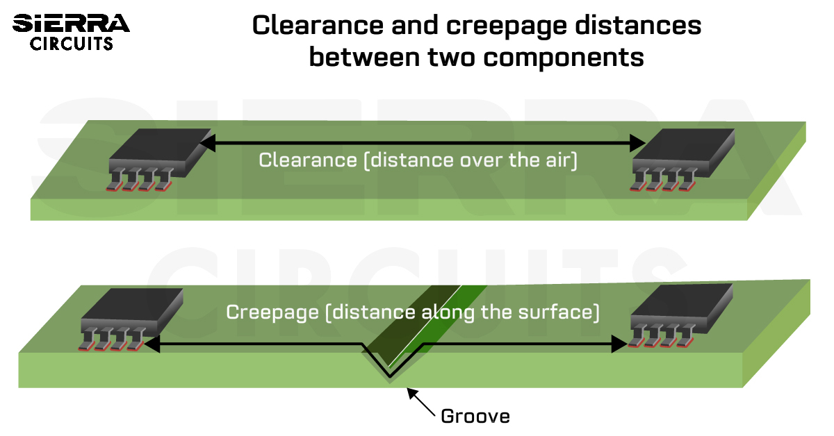

People produce videos of "dendrites" growing across a PCB in real time.
I'm following "creepage and clearance" rules for a PCB I designed that will provide some EMI filtering of mains power. It needs to work for 120/208Y and 230/400Y. I first selected 0.156" pitch connectors rated for 600V, but realized I couldn't meet "creepage" rules for distance across surface of PCB unless I either used a higher grade of material than FR4, or had slots milled between all pins. I was able to use 0.25" pitch connectors instead and stick with FR4.
The creepage and clearance table covered some common material types (graded by "tracking index"), but didn't extend down to "Marine Plywood" :ROFLMAO:
