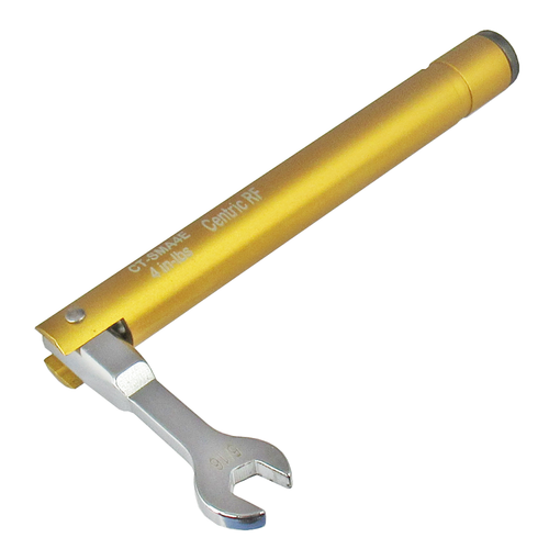

Another type is kind of difficult to over-torque with: break-over, like used for SMA connectors:
4 inch-pounds, stupid price:
Several value ranges, e.g. 2.26 to 5.65 Nm
