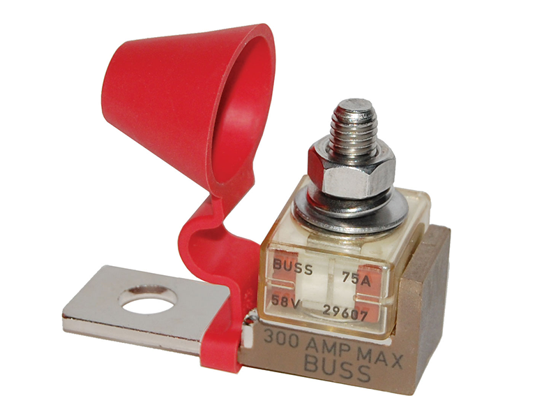

Fusing and overcurrent protection.
Main battery fuse.
Idealy you need a 'master fuse' at each lithium battery positive. Under fault conditions the battery could deliver several thousand amps
Fuses have a design 'fuse' rating that's selected for the application and an interrupt rating that specifies the current that will not 'jump the gap'. For Mega fuse it's 2000 amps, ANL 2000 to 5000 amps, depending on manufacturer, MRBF 10000 amps in a 12v system. ClassT, BS88, HRC, over 20 000 amps. Suggest a MRBF ,100A, with holder at each battery positive.
System fuses and overcurrent protection.
The main fuse at 250 amps is unnessarly high. Note the fuse does not suddenly fail at 251 amps, it needs over 500 amps to fuse within seconds and will pass 350 amps for many 10s of minutes , suggest 100 amps.
Your circuit has a number of low cost breakers, there are unreliable, have volt drops, trip at under or over the the design rating , and have been known to melt and cause fire. With your low power requirements the may not show issues, but under short-circuit failures may not protect. A economic solution is the fit a distribution fuse block close to the positive buss bar. The breaker on the solar feed is not needed.
Note a wiring error, not uncommon, is to feed a fuse or breaker with an undersized wire. Note the three breakers cables from the positive buss bar are only protected by the 250 amp ANL fuse.
