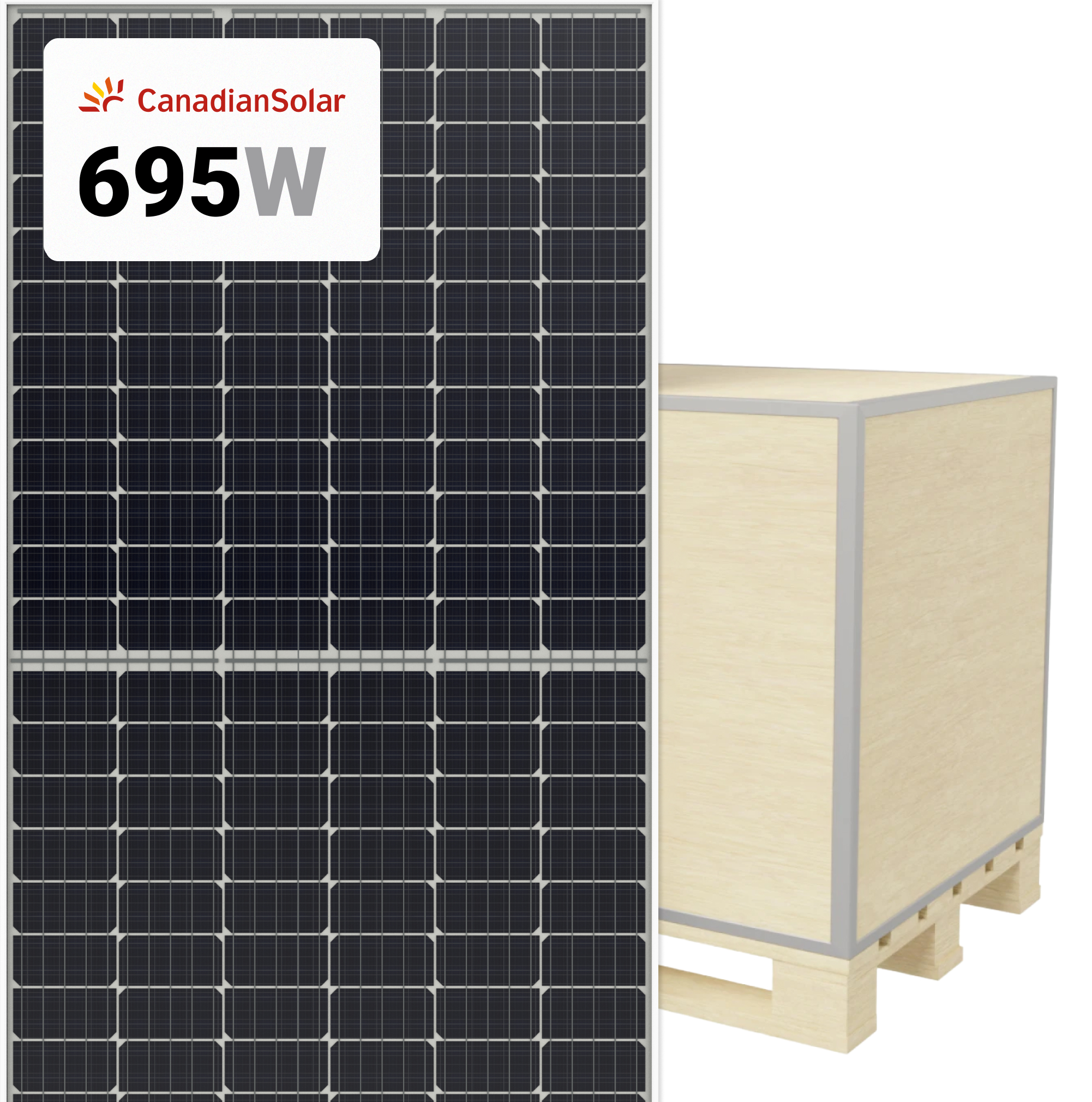

Those are basically the highest wattage panels on the market. They are larger than a sheet of plywood and heavy. You'll have better luck looking for say Canadian solar in 695W etc.
94x51
It gets a little dicey when something is this huge. I think the ~400W panel is about as large as I like to deal with (around 45x70), but if you are paying someone else, ...
In my youth I walked two 4x8 (48x96) sheets of 5/8ths up a ladder onto a roof with walk strips nailed down. Not on a bet these days. It definitely saves real estate to go big if you can make them fit.
