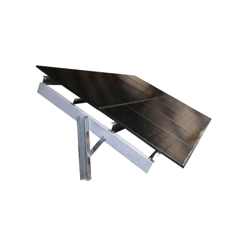

Anyone have any thoughts regarding racks? I'm going to need (3) rows that are 100' long and can hold double stacked panels in portrait orientation.
The usual suspects would be mt solar on pole mounts (big bucks) or something like these Sinclairs (not recommending shop just a link that came up). There's also Tamarack and Integra amongst others.
85° adjustable tilt would have to be custom made, if you can find someone will to do it. Sinclair only goes 55° max and they will limit pole height after it is run thru engineering. They do portrait but don't offer what you want. MT Solar is landscape only.
What are you considering for an adjuster? At 100 feet long, you will have to have a helper for adjustment or spend time walking from one end to the other, adjusting each adjuster slightly. I can turn about 3 turns before I have to go to the other adjuster, then turn that one the 3 plus another 3 and keep working back and forth. The cornish rocker does not have this aspect but it is about 60° tilt max and landscape pattern. It would take some engineering to get rows farther back at a higher elevation plus access for the tilt.
The beauty of the design is that I shouldn't ever have to adjust it - ever - because even with extreme shadows (25%) in the summer, I still would produce a crapton of energy. See below @ 25% shading (which shouldn't happen based on the height staggering of my design). Even IF they had this shading, the lowest amount in the summer months is 3293 vs. 3714 of my requirement, but I won't be using my electric heating like I will in the winter.
Since they are probably not that far away from you, you could save ~$2,500 in shipping with Sinclair if you can pickup yourself.

By the way, Sinclair told me that 85deg won't happen unless I DIY, so I need to design for 60 degrees and not go vertically staggered.
I'm open to all recommendations for equipment! I listed several brands a few posts ago (regarding panels) and I'd love to get people's thoughts.
I've given my advice on what equipment has been working for me many times. It's all I have experience with so I can't really comment on anything else.
I think others mentioned 85 degrees would be to steep for those mounts.
I can't help you there. I built my mounts using inspiration from this thread.
