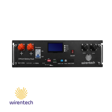

Probably why they dont have any. The ETA is mid January. Looks like just another Chinese battery brand.
If the goal is cheap, the WattCycle server rack batteries are only $699.
True but I don't think the wattcycle has ul9540A, if that matters.
Does have a display and active balancing in their v2 unit:
Wattcycle batteries can't hold a candle to Wirentech. The difference in quality and the certifications they have is huge. What you're really paying for are the cells and the BMS. The display and that balancer? Those are just add-ons. Think about it, if the cells were well-matched from the start, you wouldn't need a fancy balancer to fix things.
Moon based on your posting history I'm pretty sure you are a shill/"reputation management" for wirentech batteries.
Are you affiliated with Wirentech?
How can you speak on the quality of either, do you own any?
Everyone claims their batteries are the best. Time will tell.
what I really like Wirentech is that they are sincere enough to show their suppliers like cells, BMS, case on their website. I trust Signature Solar, they would make sure a good service and warranty.
