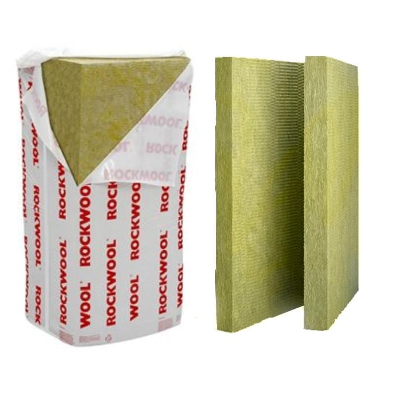

That stuff is glasswool not rockwool.
Sorry I stand corrected I had no idea there was a difference as most knauf insulation is classed as glass mineral also and basalt can be considered volcanic glass. so polyester has less than half the r-value of rockwool as rockwool is considered 33% higher than normal fibreglass.

Here, Rockwool is advertised as not being itchy. Thinking out loud ... wonder if some individuals are more susceptible to itch than others?

Polyester insulation seem to be suprisingly cheap (at least in UK)
100mm Diall 11.8GBP/m2
100mm Rockwool RW5 here in Finland 7 GBP/m2
100mm RW5 if bough by truckload: 24 GBP/m2
100mm Rockwool flexi-batt 11.8 GBP/m2
Performance-wise Diall polyester batts seem to be about same level as average rockwool.
