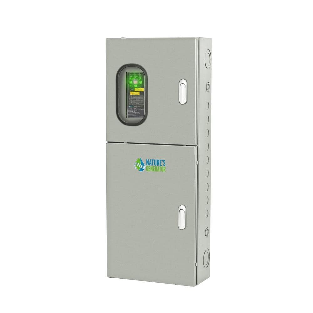

Here is a 3 pole automatic transfer switch that might work for you:
This brand also has a 50 amp and 30 amp version, that are cheaper. The only thing I don't like about these is that the unit come with its own load center.
