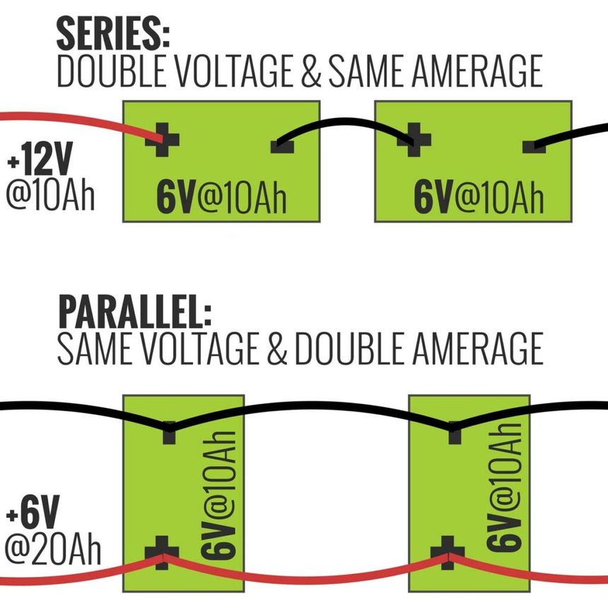

Parallel adds the amperage, series adds the voltage. Wire size is based on amperage.

You say you're only comfortable with 12v hence why you are connecting in parallel but your solar panel is 37V. If you do connect in series you need to ensure the VOC (in the coldest temperature you're likely to see) of them added together doesn't exceed the max input voltage type mppt can take.

so if my 2 batteries are linked in series creating 24v... the mppt or rather FAKE mppt will actually deliver some kind of power ???
The specification of your charge controller states:
"15-25V(12V Battery);30-50V(24V Battery);45-75V(36V Battery);60-100V(48V Battery)"
So yes, your panel voltage is within the 30-50v range, it should work. I wouldn't have much faith at how well it will work but it's worth trying if you can reconfigure your battery to 24v. You will need a 24v inverter though unless your current one can handle either 12v or 24v.

thank you.. so.. if i understand you correctly.. (forgive me if i sound dim) when i shift both cables from pos to pos and neg to neg.. and use both those cables together to link pos to neg(2 cables cuz i hate wasting stuff...) and then the negative of the fake mppt to negative terminal of battery 1.. and positive of fake mppt to positive of battery 2... i will actually get a power flowing INTO the batteries ? and please remind me.. because i do keep forgetting.. will i still have 1200 watts total with the 2 batteries linked in series.. i know the voltage doubles.. therefore it is 24V x 50 AH. .. awesome.. 1200.. that was one of he reasons i hated series.. but the watts does actually double with each battery.. but what happens if i go crazy and buy a 250 or 400 ah sla battery cuz ya.. still hesitant to use lifepo4.... .. can i add said imaginary 400ah battery in series.. itll be 12v 50ah... 12v 50ah and 12v 400ah.. how do you do the math on that ?
spank you very much for putting up with my thick skull.. i blame it on too many hockey injuries.. not playing.. but jumping off the balcony when the Washington Capitals score ....
When connecting in series the battery capacities need to match. You should also ensure they are at the same charge. Given they have been connected in parallel that should be fine.
To expand your capacity you'd need to build another 24v battery and connect that in parallel. In that case all you need to do is ensure they are the same chemistry.
Your maths on the watt-hour capacity of your battery is correct, it doesn't change as it's multiplying the voltage by amp-hour capacity.
Are you using a 12v inverter now? Do not connect it or any other 12v devices if you change your battery to 24v.
