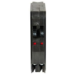

I use a lot of twin breakers like this one in 12 position 24 circuit panels:
Unlike full-size breakers, these don't have spaces for two wires (one on each side of the screw.) Not supposed to put two wires into one terminal, and with Romex sold conductor a ferrule to join two doesn't seem good either. So I splice two circuits to a short piece of wire using a wire nut. (Lately I've started using setscrew connectors instead of twist-on wire nuts. That solves the problem of not being allowed to put more than one wire in a screw terminal ... by putting three wires in a screw terminal ??)
