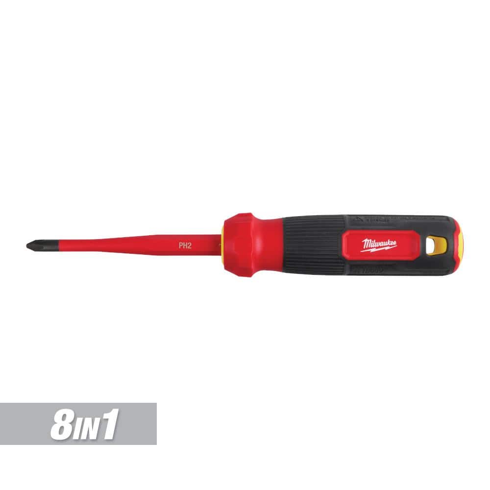

And note - the type screw that is used inside most of these breakers that looks like it will take both Phillips and slotted is not actually that... It is ECX according to Milwaukee ... but if you don't have that type bit it is a square drive or slotted.... not Phillips at all. Below is a picture and a link to a driver set that includes the correct insulated bits.
Thank you, Rob, I'll get exactly what you suggest.
