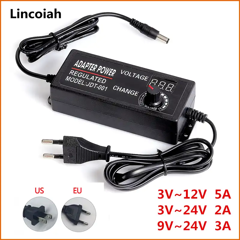

Verstelbare-Ac-Naar-Dc-3V-12V-3V-24V-9V-24V-Universele-adapter-Met-Scherm-Spanning-Gestabiliseerde.jpg_q50.jpg
Can I use this "powersupply" for top balancing per cell ?( I have plenty tim
If I use a multimeter to be sure its giving 3.65volt it would charge the cell until it reaches 3.65 ?
I'm counting on 4-5amps ?

What am I missing with the current drop on these power supplies? Why would the supplied current drop using a power supply. The voltage and current are set, and should not vary. Are these special DC supplies on some way that they also act as chargers? The answers to questions on the moderate priced unit Will has links to specifically says the current will not drop.
If you are referring to parallel top balancing the problem is the very low voltage we are dealing with. If using the step balancing method where one starts charging the cells at 3.4 volts the current will drop substantially. If one starts charging the cells at 3.65 volts then the current should remain at whatever the power supplies current rating is providing the cables are big enough to carry the current. I tried the step method and skipped it as it was going to take too much time.
For example, when parallel top balancing using a power supply set to 10 amps and 3.65 volts and then connected to the cells, the voltage will instantly drop and the current should remain at 10 amps, and the power supply will be in CC mode. There will be some voltage drop between the power supply and the cells and this is ok. The reading of the power supply's voltage and the voltage measurement at the cell will not match but will be close.
Once the upper knee of the cell is reached, the voltage will begin to increase and the current will begin to drop. When the voltage reading on the power supply reads 3.65 volts, the power supply will switch into CV mode. At this point the voltage will remain at 3.65 volts and the current will begin to drop. So both current and voltage will vary, and this is typically how a charger works.

Ok, so the power supply has to support CC and CV modes, or else the amp display will not show a drop as the cells reach the target voltage? Is that correct? If so, which power supplies support that? The cheap 30v 10a Will shows is out od stock, and the next 40a supply in his list indicates the amp and volt parameters will not change like a charger as the cells charge.
I am not in a position to recommend any power supplies except the one I used and it is the Riden RD6012. Since I bought mine Riden released the Riden RD6018. I bought the complete kit from Aliexpress.
If you take a look at Amazon you will find most if not all of the basic 10 amp power supplies like Will used support CC and CV.
