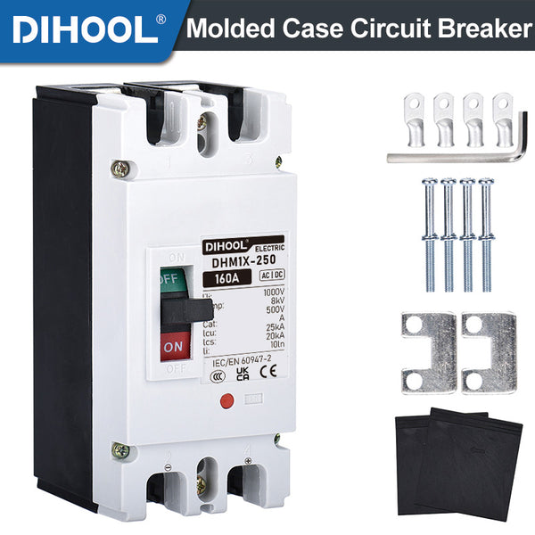

I've installed two single pole DC breakers with 160A for my 2 pairs of R4875G1 DIY Chargeverters. They look exactly the same like the single pole 160A DIHOOL but they are from HESCHEN (same size, same weight, etc.). You need a lot of force to toggle the switch - they are really robust also the screw terminals. No issues so far and I'm happy with these breakers. They stay cool with 155A tested. They are about 40% cheaper compared to DIHOOL (the pictures here and here shows them installed - the first picture link also showing thermal images while at 155A). They are also available in 2-pole versions.
Thanks but Im planning to use these on hybrid inverters so what i would like clarification on is if the Dihool DHM1X is polarized (unidirectional power flow) or non polarized (bidirectional power flow)?

Yep that document came with the breaker. But check the notes at the bottom..Looks like they contradict the schematic which calls out the load connections at the bottom. Hence my question.
Here is a teardown of that type... I've opened up a number of them... the good ones have good fit and finish...they have lubricant at the contact points for the moving parts. They all have arc chutes and the contact points appear to be plated with sintered tungsten. The rocker arm of all I've opened is made from aluminum... although I might need to open a few back up and check that...all of the places where the cables bolt seems to also be aluminum. Some have a nut pushed into the back side for the screws to thread into.
Other than edges that don't meet properly there isn't a way to tell the good from the bad other than brand... taixi, tomnz, and dihool are all good brands... the no-name like picture and chintz aren't great.
The better ones have an extra piece of what looks like epoxy board to direct the arc as it goes across the divider. This protects from the arcs from hitting the plastic sides. I intend to do some testing when I get setup to see if they flip at the rated current...

What I don't get is why the Dihool DHM1X is marked with line and load sides if it's bidirectional and unpolarized? Just makes me suspicious. Any thoughts?

All of the ones I have in my possession are marked for line/load in one way or the other --- they are polarized..... This tracks with only having arc chutes at one end...

The Taixi and the TOMZN are both really good quality inside and out -- DiH00l (note that is zero zero verse 'o' 'o') -- is the same parent company as Taixi ...

So far as I know this little jewel here indicates it is polarized -- Line on top, load on bottom
Looks like the arc chutes only face up towards the line as well.

I just ordered a couple of the black ones as well. DHM3Z-320 250A. Going to return the ones I've got since it's looking like they are probably polarized although the documentation is ambiguous. These perform a critical safely function so I don't want to take a chance.

So they replied, and said that they were unpolarized. But I just realized that they might indeed have a source (e.g. battery) side and load side. I'm asking them about that.
They can be used between the SCC and the battery no problem --- SCC in on the top, battery at the bottom
What you can't use them for is between the battery and the inverter - if the inverter charges -- if you do all bets are off
