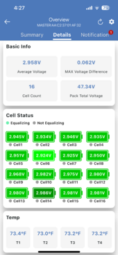

Having issues with my 5 KW eco worthy solar set up off grid. Set it up in May and it worked good until June then stopped charging, it would only charge around 10% a day. Moved the panels around and got it working a few days ago to charging the battery at 100 %. Anyway since then it’s been in discharging status, I’m at 11% now, eco worthy support haven’t given any ideas forward yet so I’m looking to see if anyone has any idea what I can do, I’m a complete novice :)

I'd start with increasing 37 to 54V, currently it's waiting until it hits 52V to recharge.
Then I'd reduce 57 to 2A.
Is it a 16s LiFePO4 battery?
08 likely needs changed too...

Sure,

Thank you, I tried that today but nothing different yet it’s still discharging but at 8%
What about changing setting #1 to battery first , better yet what about trying the same paramater as mine I basically uses almost the same default settings..
Just notice # 8 #32 and #33 options are not correct because you have a server rack .
Yes, in the day it gets a lot of sun. Last week it was at 100 % but then suddenly started discharging and not charging again. No it’s not on the grid, I did adjust to your suggested settings. It’s at 8% now so I’ve turned it off as it started continuously beeping. I’m wondering if the best time to try again is when the sun is up tomorrow. I do have the communication cable connected I’m not sure if that makes any difference.
You'll want it disconnected if you're using the settings I posted, especially setting 8.
I'd also change 6 to PV1st.
Tomorrow when the suns out check the display for PV production, screen 3 will show PV power.
As 420ohms PA mentioned earlier there’s no grid input connected to the inverter and the inverter will not function with low battery,
I strongly suggest that you connect 120v input grid power and set #1 as battery first #4 43v #5 53.6 #6 hybrid and since you have a server rack battery (although you have the cat5 connected but you have no connectivity) because #32 communication is not set and you needs to change to 485 and #33 BMS needs to be set to the corresponding battery manufacturer otherwise the battery is not going to charged, if you try these suggestions you will see some changes .
Good luck.
Well it was at 1% when I got up and woke me up beeping again. I patiently waited with the new settings for the sun and…… were charging!!!!!! I’ll keep you posted but so far it’s finally charging.
Good luck.
Thank you ☺️ I changed it and so far charging
So, its charging in the day, very slowly but I guess it's the lack of sun at the moment. It goes into discharge status at night- is that normal? is there a way to stop that?
Keep in mind that your system is a 5000 w inverter with one single 48v(51.2v) 100Ah server rack battery , this setup is basically one hour capacity or less fully charging depending on your load consumption.
#1 your best scenario is to connect the grid power to the inverter with #6 hybrid setting , where the grid will supplemented charging whenever battery is lower than #4 setting value and also will charge the battery to # 5 setting parameter.
#2 looking at your solar panels layout I am not sure if you are getting enough sunlight exposure and with the battery so low , a couple hours sun is not going to charge the battery and running load at the same time.
Good luck
