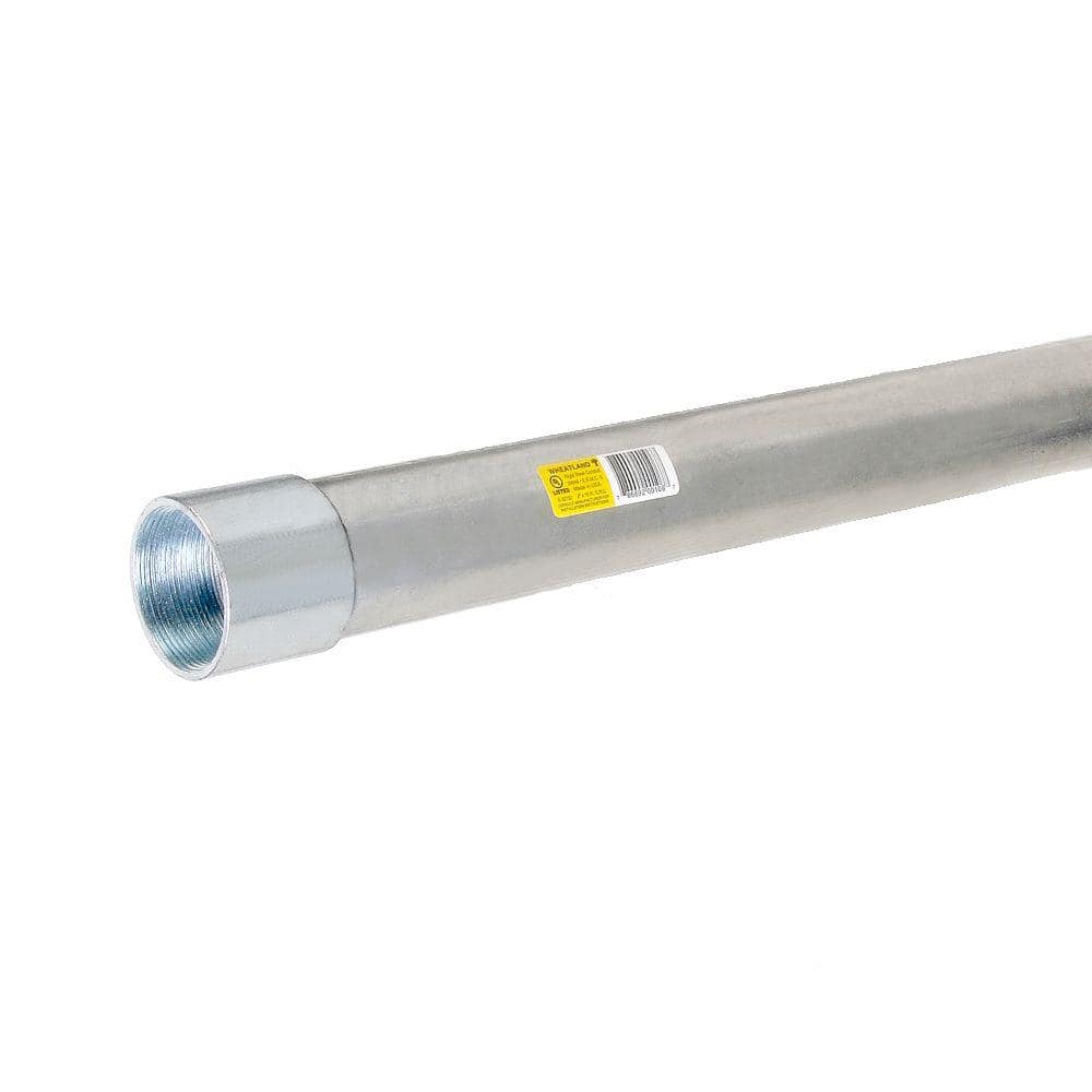

Not that the structures I build cost any less:
For one, if I take that cost and break it down, it comes to (roughly, don't have the numbers in front of me):
- 110 Euro for the wood
- 30 Euro per concrete pillar, total 6x = 180 Euro
- L-brackets and fasteners 30Euro
So most of the cost is actually in the concrete, the wood and fasteners are less than half the total cost. Using metal conduit and mounting rail would make this more expensive (in part since they're not that easy to get here). I would still need the concrete pillars since I can't drive a pole in the ground or anything (thin layer of topsoil, and then it's all bedrock). Granted, I could make them myself and save a little, but I have too many other things to do.
