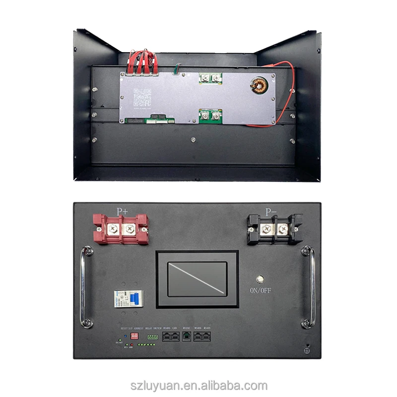

You could have saved a pile of cash, if you had bought all the cells,m case & BMS from one vendor who could then bundle the small bits into the boxes and reduce the Per Box Fees & Rates. There are fees for every box, then the S&H + extras for every order. That can add up Extremely fast when buying from separate dealers.
There are 16S case kits ranging from $175 USD up to $700 USD (yeah, pretty shocking yet some get suckered)
Note that some will include a BMS etc therefore that is reflected in the cost of the "kit".
Depending on "Style" of case, that can also affect the cost, ie Floor Standing, Wall Mountable, Rack or Shelf Style etc.
Best Bank per buck for 16S Standard Shelf Case (too heavy for racks) is available here.
NB: Get a proper quote with S&H via a Chat/Messenger session, the S&H Guessometers really suck !
You need to select the BMS type you are choosing for the display or not etc....
FYI: Currently we do NOT RECOMMEND JK-BMS-Inverter Edition due to the numerous flaws, issues and absolute lack of Tech Support. They do work fine in Open-Loop systems that do not have to interact with an AIO but are terribly troublesome in Closed-Loop. Unfortuinately I cannot suggest or recomewnd an alternate at this time.
