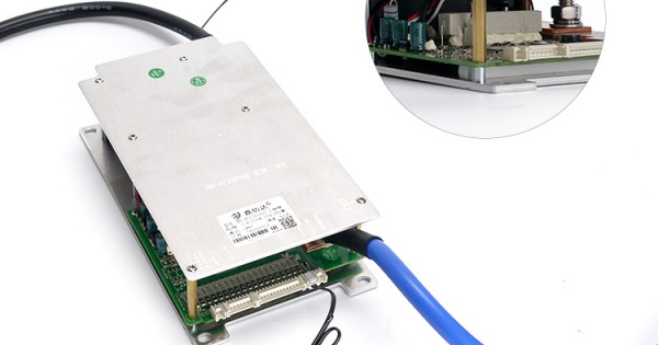

Of course, we need a BMS. I'm going to pick one I have experience with, and I'm not picking the cheapest one. The 200A with 2A balancing JK BMS bought from Aliexpress would set me back $185 with free shipping.
The Docan 200A BMS works great and has pre-charge built in for $140 shipped. -$45

The pre-charge came as a surprise to me, I had used my circuit breaker to try to turn on the power to the inverter and nothing happened except a click. A look at the BMS showed an over current protection event. So clued up I left the CD on and hit the on/off slider button thingy in the App.
She fired up then. I repeated a few more times just to be sure, totally repeatable behavior.
The relay is a super heavy duty device with a very small holding current. Nice piece of kit all round.
