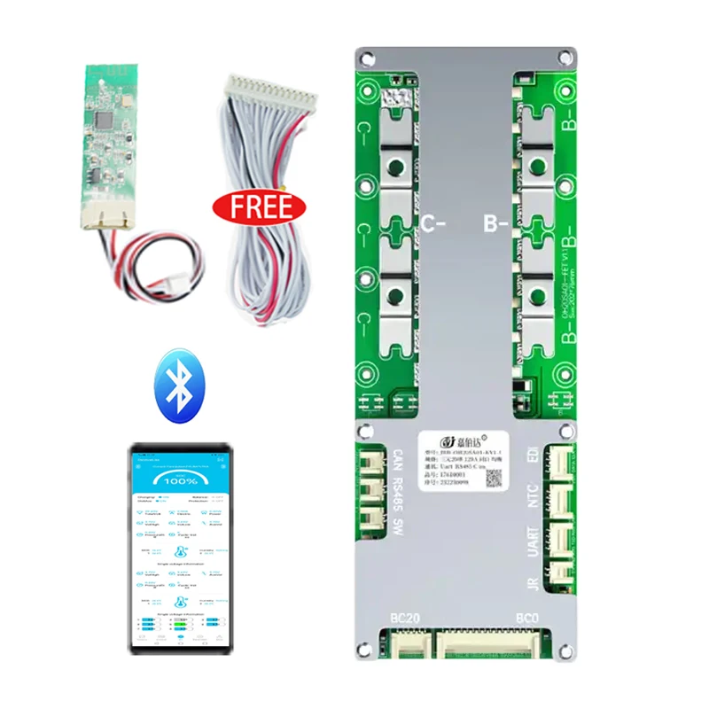

and the bms, a bit of Google translate magic from Chinese
