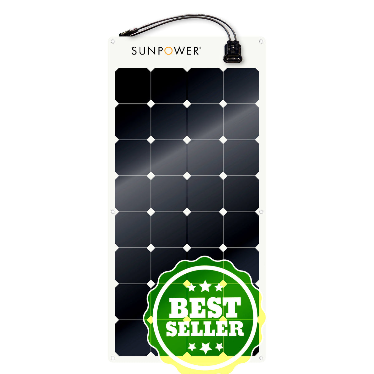

Looking for waterproof panels with grommets around the edge for strapping across gear for multi day kayak camping trips.
Somewhat flexible and of course durable to handle a little abuse, mostly edge bumps and gear falling on it etc.
So far only found some sunpower models. Other brands have reviews that say they stop producing after 6mos or a year.
Folding models are less desirable but a possibility.
Historically, these guys make some of the toughest like that.
Probably the 200 watt BougeRV cigs panels (or the narrower 100 watt versons) would work for you. They have a version with small (5mm) grommets that roll up into a cylinder that is about 11 inches in diameter and weighs 6 pounds (for 200 watt version). About 27 inches wide so it would roll up 11" diameter by 27inches. Alternatively, two of the 100 watt versions would roll up into about 12" diameter by 15 inches (both could be rolled up together)
What I have but not used except for testing so far ($120):
WindyNation has a decent reputation here. These look interesting but no knowledge of durability ($95):
I have had two sunpower 100W on the back of my sailboat for the last 5 years. They work great, very light, no delamination, not a noticeable power drop. I have heard that you need to keep them from overheating to keep them in good shape, like placing them on a surface without ventilation below is bad. Sunpower is on the edge of bankruptcy, which is unfortunate. They make great cells
