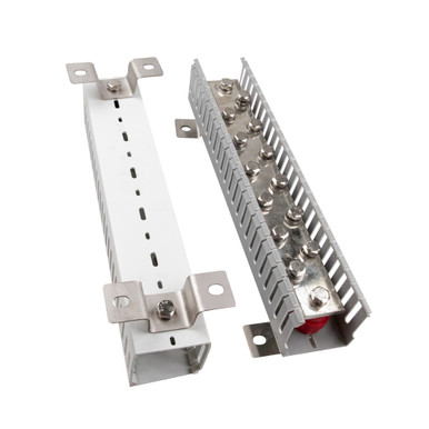

I'm installing a 12v Quattro II 3000 with 4 12v LiFePo4 460Ah Epoch Essential batteries (200A continuous, 400A peak) in parallel. I'm planning on putting 250Amp MRBF fuses on each battery terminal. Based on Epoch's recommendations I'm going to use the busbar method using a Victron Lynx Power In, so now I'll have an additional blade fuse on each battery inside the Power In. Then I'm going to put a 400A T-Fuse (Blue Sea) for the AIC rating between the Power In and the Lynx Distributor.
Does this setup sound appropriate and maximally safe? Please advise.

Were it me I would skip the Lynx and just use a pure copper bus bar with the appropriate number of studs...
These are the cheapest red/black with lots of studs... you can also get good ones from amazon by pike industries... the main thing is look for pure copper... if it doesn't say it is, then it is brass.

I'm reluctant to make my own busbars because this is a mobile application and my lack of experience. I'm going to need 5 studs, my first choice would probably be the BEP Marinco 650A busbar, they seem to make really good products and I'm using their T fuse holder and master switch already, however I'm not happy about the price which seems overpriced ($100) and I'd need 2, $200 seems overpriced when the Power In was 140...
So I'm looking for cheaper option that very high quality, I discovered Daier which seems to make pretty solid products, considering this 400A solid copper busbar that goes for about $55 for both positive and negative, it has one more lug than I need but that doesn't matter. I'm a little worried that my lugs won't fit due to how tightly packed the lugs are.
I just discovered that Epoch makes what looks like a pretty good busbar, I'm not sure the amp rating or the lug size, I'll have to message Epoch.
Finally, I'm considering going back to my original plan which was just linking all the batteries together in parallel using the halfway method, without MRBF fuses and just the T for all 4 batteries, which I discussed here:
Open to further advice also :)
The epoch bar doesn't say what it is made from so I would ask before buying. The eaier bars look good to me. Bep makes good stuff, but they are pricey for what they are.
I would buy the eaier from the ones you listed.

And avoid ANY Amazon bus bars for high current stuff like this. There are some on Amazon that look like the the Daiers one, but are likely not pure copper underneath the nickel.

The current choices I am considering are:
10" wire run from the battery to the Lynx Power In busbar, where each battery will have it's only mega fuse then the class-t fuse between the power in and the Lynx distributor. My main power switch will be directly after the class-t and before the Lynx distributor. I think this covers what you mean by the "pre-charge" circuit?
OR, the same as above plus an MRBF fuse on each battery.
In the first scenario each battery is protected by a mega fuse 10" from the terminal, mega fuses have terrible AIC ratings but in the event of catastrophic mega fuse failure the class-t would still protect the rest of the system. Please correct me if I'm wrong but fusing within 10" of the terminals seems technically adequate.
In the second one I protect the 10" of wire from the battery to the power in busbar with the terminal MRBF fuses, the 10k AIC rating of the MRBF fuse would *probably* be enough and the class-t would be backup just in case. The mega fuses in this case become rather pointless as far as I can tell, but they allow me to use the power in busbar, which is worth it to me and it does add some (maybe pointless) redundancy.
Tangent: I'm annoyed the MRBF fuses are M10 and my battery terminals are M8 but as I understand it this technical incompatibility is frequently done without issues. My MRBFs are M10 to M8 (they were provided to me for free) but I've searched and M8 to M8 MRBFs don't seem to exist so...

Nope, not at all correct. Pre-charge circuit is connecting the inverter to the battery through a very large resistor (both ohms and power dissipation capacity) in order to allow only a relatively tiny bit of current through to charge up the capacitors. Because capacitors, when near empty, can sink tremendous amounts of currently extremely fast they can pop fuses or cause battery damage or LFP BMSes to shut off.

MRBF fuses are better than MEGA AFAIK, so I'd go for MRBF fuses. And since your fuses on each battery will be lower than the Class-T, those are more likely (in general) to probably pop first. And the Lynx Distributor is the one with MEGA fuses, the Lynx Power In is just the bus-bars. Although with some nuts and bolts you can effectively turn it into a Distributor without fuse monitoring.
Distributor (with fuses) https://www.victronenergy.com/dc-distribution-systems/lynx-distributor
Power In (no fuses) https://www.victronenergy.com/dc-distribution-systems/lynx-power-in
As for M8 -> M10 MRBF holder, you probably could get a short chunk of pure copper, drill an M8 hole, and then an M10 hole, and mount to your terminal and then the MRBF to the M10 on the copper. Not sure the thickness/size you should get, I haven't done this.
