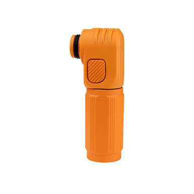

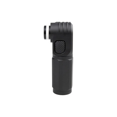

Looking to build my own cables for my EG4 PowerPro batteries but am having a hard time finding the specs for the connectors.
I believe the general term for the connectors is Amphenol but that is generic for the style.
I'm located in Canada and Mouser Electronics sell the Radlok version but I'd need to know the specs/size/architecture etc, to ensure I pick up the correct ones.
Signature Solar and others sell them but leave out the specs.
If anyone has purchased the correct ones in Canada, I'd appreciate a heads up.
Cheers!
They are manufactured by Degson. They are 250A water tight connectors, but I do not have a model number.
Thank you very much for taking the time to reply. I've found the Degson ones as well. I think the part number is:
ESP-250A-70-BK-00.​
Unfortunately, I can't find them in Canada.

TOP-electronics USA in Tucson AZ carries these and ships to Canada

FWIW, I did find a source for custom made cables that are very reasonably priced. A set of 10-ft 2/0 cables with the correct connectors (ESP-250A-70-BK-00) on both ends, fully assembled: $194 plus $16 shipping
I have no affiliation.
OK, received my connectors from TOP-Electronics (Very happy with the transaction). I went and got a lifetime supply, may sell some cables on eBay, not sure. But with the flat shipping fee I figured I would buy a bunch and maybe recoup my costs by selling extras. These are relatively hard to find! Time to make some cables!
