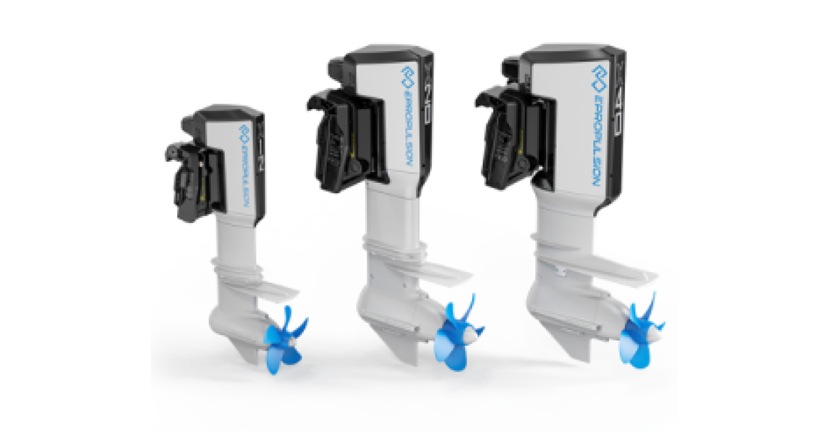

Except if your outboard is also direct drive like many electric outboard.
Even without direct drive and with a set of bevel gear, you lose what? 5% efficiency at max.
I suspect that the fast rpm propeller of MA-3D jet is way less efficient than the low rpm propeller of an E-outboard.
All those small outrunner motor have to spin really fast in order to output kW.
Example, the 25kW is rated at 35Nm max, so it need to reach 7000rpm to output that much power.
I don't see how a propeller can move water efficiently at that speed.
Look at Torqueedo, e-propulsion or other, they all use low rpm motor/propeller combo (1000-2000 rpm).

My limited understanding is that outboard transmission loses are closer to 10-15%. Haven't seen any higher power direct drive electric motors, do you know of any? Would be very curious.
My understanding about the impeller in a jet is that it runs at much higher rpms than the propeller in a standard outboard. That 7000rpm would be a reasonable number.
However, I'm definitely not a boat engineer, so good chance I'm wrong!
Sure.
Sure.
Ya, seen those, they look nice but rather pricey. I don't believe they are direct drive. The motor has a drive shaft or a belt or something?
I thought the only way to do a direct drive prop was to put the motor in the water, so it's only practical with smaller motors.
