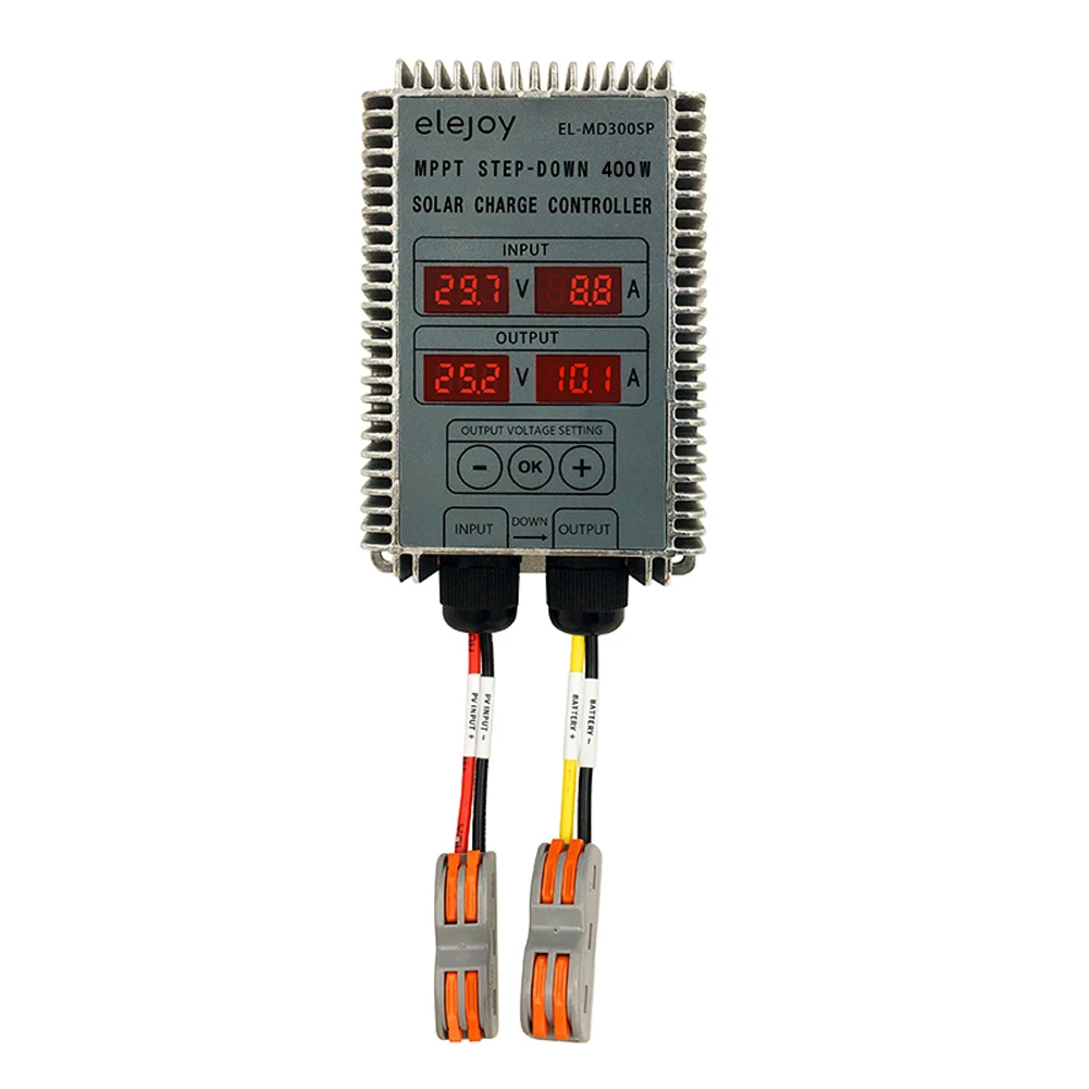

Warning: This cheap charge controller feeds back over 90V to solar input after charge stop. This high volt feedback voltage destroyed one of my bench power supplies. I guess after charge stop the capacitors inside discharge!? Neither the battery (used a 12 volt one) nor my now destroyed power supply (up to 24volts only) was able to produce 90+volts so it definitely comes from the charge controller.
Also the efficiency of it was not as advertised. Further the readings of those meters are off quite a bit. Better stay away from this controller.
