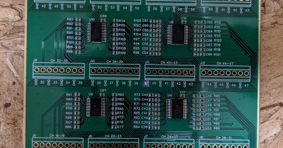

I've found some 50mm thermistors that might work. I also located a 10 thermistor data logger that should help with sizing and calibrating the heaters.
Nice! Let us know how it is, I can't tell from the webpage if the assembly means you have to supply the parts? Either way, it'd be nice to know if the 10 sensors all read the same (or if there's a calibration process).
Sure. With PCBway you can get the board and parts and assemble yourself or have them assemble. The SMD parts on this board aren't tiny so I think assembly is possible by most that have a little experience. The code isn't that complex. If you use 10k NTC thermistors you can install the 10k resistors and set all 10 connections to use the 10k value for voltage divider. For lifepo4 uses I'd imagine the 10k/10k gives the most flat curve over the range we are interested in. So if you want PCBway to build it just leave the default BOM. If you had other needs this is pretty flexible. It's not all that polished, but it can do the job on a test bench.. or in my case a deep freeze or an industrial freezer that goes to 60 below. It doesn't make connecting the display elegant like you would want, but buying and not making something like this saves me time.

The thing I couldn't parse was if I bought the 'assembled' version, do they supply the parts or do you have to buy to the BOM and send them in?
I have an application for something like this, but the last thing I need is another unfinished project. ;)
For this project they supply the parts. You still have some work to connect things and load the code.
You can also look at this one. He has a Tindie page for it. Very reasonable price for 60 inputs. Also easier to use if you are sourcing cheap thermistors with no connectors.
