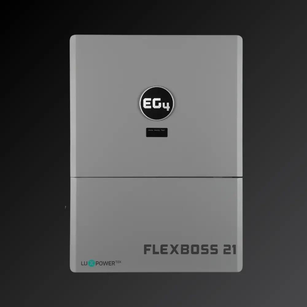

Ok, I re-wired it my AC coupled solar to the load port on the Flexboss. You now lose any measurement of AC coupled solar power:
See me charging my batteries at 6677w and exporting 232w magically? before you would see it coming in on a smart port.
Additionally, I got a total blackout after 7 minutes running off grid. Hey, at least it is getting faster and easier to troubleshoot.

Grid up, AC coupled solar on smart port works very well.
Grid goes down (by me flipping breaker from meter), settings are strange. "Start" feels weird since the value must be below it. AC coupling turns on and feeds batteries/loads.
After some time between 5-120 minutes, total blackout of gridboss and flexboss21. Only turning back on breaker restores anything.
A new whitepaper came out explaining you can do exactly what I am attempting, and it should work:
I re-wired it to be on the load port of the Flexboss21, and same issue, but failed even faster after about 7 minutes.

I have never been less than 50% when it is a blackout. I doubt it is SOC issue.
If I had to guess it is too much power. AC coupled solar is just dumping a lot (up to about 12KW in my case) power into the system. I am not consuming even close to that. When coupled at the smart port, I would see it take the excess and put it on the batteries, so for a time (1 hour or so) it works beautify, just as you describe.
And come to think of it, with the new re-wiring I did to the load port on the Flexboss, how can it cut off the AC coupled solar? Is there a relay on that connection? How else can it kill it as described in your #3? We know there is on the smart port.
Just did another test today, and at least I am getting consistent. about 5 minutes after flipping grid breaker, blackout.
I bet it is not a coincidence that is exactly how long it takes the AC Coupled solar to wake back up.
The fact that it works when wired into a smart port still makes me believe it will work longterm, just need a software fix. I don't mind being a bleeding edge user, but I think EG4 does need to figure this out. Think of the millions of existing AC coupled solar systems. Huge market for them.
