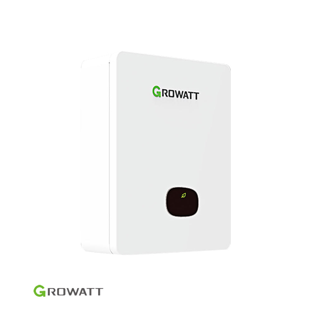

1. If Growatt makes a hybrid, >12K, split-phase, frequency modulating, 200A utility bypass, 400V battery storage capable inverter - I am all eyes and ears.

Largest growatt is 11.4kw

Awesome, thanks! I just checked out the Growatt. I didn't see where it stated frequency shifting capability - AC coupling was supported, it's UL1741SA certified, so you'd think it would have it. If it supports non closed-loop BMS communication, I will investigate further. If it's proprietary battery packs or comm protocols only, then I would have to shut that idea down. I'd planned to use Orion's BMS'.
