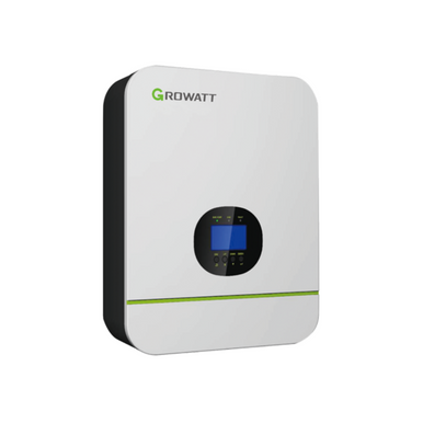

This unit:
Has a 145Voc limit and only needs about 66Vmp to be able to charge a 48V battery, but it's also limited to 145Voc. This means you're limited to 2S 24V panels (45Voc each) or 3S 60 cell panels (36Voc); however you can parallel the crap out of them as the only real limit is the 80A MPPT output rating - generally speaking, when you don't have a published limit, you use that one.
Your proposed hybrid config would maximize RV-only PV performance with the Growatt as you could place fewers panels in series and more in parallel to address partial shading performance.

This unit:
