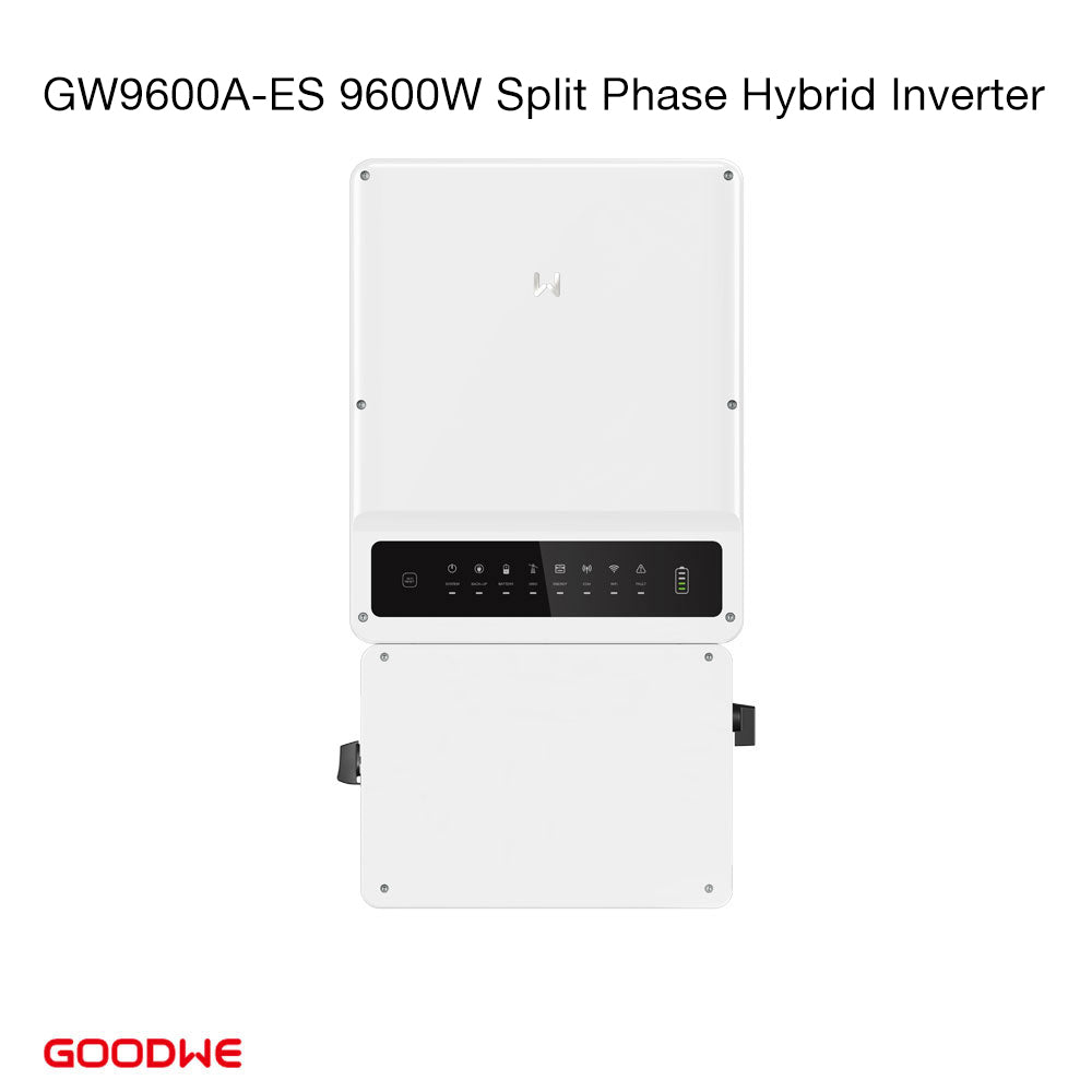

In terms of equipment selection, the first set of panels I bought were 20 Heliene 360W panels, then later I bought a pallet of 38 Canadian Solar 400W panels on a clearance sale. I used Ironridge mounting hardware. Here's a couple of pictures of me mounting the panels on the roof.
I started out planning to use SMA inverters. I had an earlier system based on two Sunny Island 6048 inverters along with Victron MPPT charge controllers and Tesla Model S battery modules. So, for this system I was planning to use a SMA Sunny Boy 7.7kw PV inverter and a Sunny Boy storage 6kw ESS inverter. I also decided early on that this system would be based on a high voltage battery system. My previous system was a 48V battery system and I wanted something more efficient and without the complication of heavy wiring, busbars, fuses etc.
But two things caused me to shift directions. First the order for my SB 7.7kw inverter was put on back order because SMA decided to suddenly phase them out and introduce their new line of all-in-one hybrid inverters. It was also turning out to be time consuming to reverse engineering the CANBUS battery interface on the Sunny Boy Storage inverter due to the proprietary nature of SMA.
For the inverter I came across GoodWe. GoodWe inverters aren't that well known in the US, but worldwide they are one of the biggest suppliers of inverters in the world. They are also on the approved equipment list in many states including California. And I checked with the local authorities where my houses are and there wasn't going to be any problem with getting them approved for grid tie. GoodWe inverters are also sold by GE in the US under their brand and they are now making a much stronger push into the US market. Net, net, I was convinced it was a good quality product that was well supported.
The other factor is GoodWe is not super proprietary about their stuff like a lot of other inverter manufactures. That made it much easier to figure out the battery interfaces.
I ended up deciding on the GoodWe GW9600A-ES all-in-one hybrid inverter. It has four 15 amp MPPTs that support 150% DC oversizing with up to 600V input. It supports grid-tie and off-grid operation as long as you install the associated autoformer. It has built-in energy monitor and tigo rapid shutdown support. It supports grid-zeroing if you want that and it has an economic mode where you can define time periods throughout the day and define exactly how you want it to behave during each time period. I also discovered just by use, that unlike some inverters that say they support DC over-provisioning the GoodWe will go way over 9.6 kw with my 14kw of panels. Since it's a DC coupled system between the panels and the batteries not all the power has to go through a DC to AC conversion. It's really common for me to see 13kw of power coming from the panels with some of that charging the batteries and the other part going to power the house or be fed into the grid.
It also has an acceptable mobile app and web based monitoring and reporting. I say acceptable because I've been able to get it do everything I need, but it could be better. But I will say it's gotten better and better over the time I've had it. Also because GoodWe isn't super proprietary I've seen all the interfaces needed to intergrate it into Home Assistant which is something I'll likely do in the future.

Yes, the GoodWe inverter requires a data connection to the batteries BMS system. I've never seen a high voltage inverter that doesn't require comms with the BMS system. From an engineering point of view, there are two reasons why that's typically the case.
First is because by nature a high voltage battery has to have quite few cells or cell groups in series. Therefore, it's pretty important to make sure the battery pack is staying in balance for safety reasons. And in high voltage and power battery systems, it really not the best solution from a cost point of view to have the BMS control the current flow to/from the battery since the inverter typically has to have relays or FETs to control the current flow. So, the BMS on an HV battery does all the monitoring and balance functions, but it tells the inverter when to start and stop the flow of current for error scenarios.
Second reason is to open up the flexibility of the design and support of different battery technologies in the HV battery system. By delegating the control of the battery safety logic to the BMS built into the battery system. The inverter no longer has to have much knowledge of how the battery works or what kind of battery chemistry is used.
With all that said, the GoodWe has the widest battery support I've seen of any HV hybrid inverter. It supports both CANBUS and RS485/Modbus battery interfaces. And it has choices in the setup for almost a dozen different battery makers. Also for a fair number of the protocols it supports, there is enough info available online to build your own interfaces to the inverter.

The trick is to get the system inspected before adding batteries. The inverter doesn't require batteries to operate, at least mine doesn't, it'll do PV Net Meeting with just panels and the inverter. You just say you want the ability to add batteries later, if asked.
The GoodWe inverter is UL Listed and on the California approved list. That's one of the reasons I went with it.
