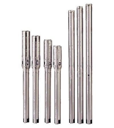

Helping out a friend here in AZ. His well gpm rate is pretty wimpy. He has 2 extra panels lying around.
The system is a twenty year old Grundfos ac/dc well pump, low output (3gpm), only pumps when the sun is out. It fills a 1500g storage tank (float switch back to the pump) up on a hill, and then this gravity feeds a two small tanks several hundred feet away.
Currently the system has 3 “Grundfos” 65w panels in series. Surprisingly high voltage, with vmp of 31.4v. So when this was new, the panels would have provided 195w, 94.2v (2.07a).
The mppt/pump is rated 300w max, 30 to 300v, 8.4a max.
The other two panels are also twenty years old.
I did an amprobe/short circuit test on all 5 panels, and surprisingly, they produce a little over what you might expect for old panels. But the sun is strong here!
The amperage will be 6 times higher and the voltage right at the bottom operating range. I believe the wiring to the pump is 10g UF, but might be 8g. The cable length might be 50’ to pump and 250’ down, so total of 300’. Voltage drop could mean mppt doesn’t work.
Anyways, here’s a picture that describes this better. Please tear this apart 😝

Your new plan has more problems than solutions. First of all the well may just not put out more than 3 gpm. Or the pump is just worn. Your proposed plan exceeds the pumps specifications for both wattage and amperage and the voltage is way low. If the well can flow more I would replace the whole system.
We need the model of the Grundfos before we can be of any real help. It may be that the pump is doing just what it is rated to do. There are several that fall within the electrical ratings you describe.
Based on your "30-300V input" statement, I am assuming you have one of the SQFlex series. As long as you don't exceed the 300V max rating (over that and the pump will shut down) you can add more panel capacity and nothing bad will occur. The GF will take what it needs up to its max input power rating and ignore any over that. You'll need to observe all the things that need to be taken into consideration regarding connecting panels in series/parallel to actually GET more power.
More power WILL work for you in one way - the pump will start pumping sooner in the morning and stay running longer in the afternoon.

Thank you both for the good points. I don’t know details on the well, which you point out is necessary information.
This is in Patagonia AZ; he had the well dug and system installed. Perhaps 280’. I’ve learned that recently he had the pump replaced (with the same or similar model) as a precaution. Likely a 3-SQF-2?
My intent was to see if gpm was being limited by available power. The pump specs show 300w draw maximum. When the panels were new the maximum potential was only 195w. Perhaps one more panel twenty years ago would have yielded more gpm.
Yesterday, measured in full sun the panels maxed at about 50w each.
My main concern is the MPPT struggling with the borderline voltage with the different configuration. It should max at 8.2a draw at 30v. Same as if it was supplied by a 30v 280ah battery.

I would say if you are getting 3 gal/min and you indeed have a 3-SQF-2, you are getting all you can get.
If you can find out what depth the pump is set at and what the static water level is when you start pumping, the interactive pump curve chart on the Grundfos site will tell you exactly what to expect from a given power input:
Those curves for the SQF-3 are spot-on when I check them against what I'm getting in "real-world" use.
My well is drilled into Navajo sandstone so I knew it would be a low producer. But I can pump close to 1K gal./day when I have six hours of daylight. The 350W of panel helps here, getting pumping started early in the morning and allowing it to go late into the afternoon.
Since my culinary use is about 10 gal/day, I have more water than I will ever need. But the drip-irrigated garden is still a work in progress... Everything wants to eat anything I try to grow, regardless of the "industrial strength" barriers I put up. I will win this battle eventually, when I get serious about it.
In your case more panel would help by providing a longer daily "pump window", as already mentioned. Since you're in AZ, you can perhaps make a trip up to SanTan Solar in Gilbert and get some cheap used panels. A couple of 250W / 40V panels will run you about $100. Wired in series, the higher voltage will keep the current low on the submersible cable. More power than is necessary, but the SQF will take only what it needs.

Yesterday I experimented with different panel combinations. Here’s what I found, as measured at panel end with 2 Kaweets (one clamped on and one measuring voltage. It was partly cloudy and all 5 panels mounted, laying flat on sawhorses.
3 65w in series (original config). Measured 95v/1.1a. 104w. Pump ran.
3 65w inverter in parallel, 2 120w in series, combination in parallel. Measured 35v/4.2a initially. 147w. Voltage steadily dropped with amperage rising. Pump turned off within 30 seconds (below 30v at the mppt). Fail.
All 5 panels in series. Measured 143v open circuit. Volts dropped immediately and pump didn’t start. Fail.
2 65w in series, 1 65w and 2 120w in series, combination in parallel. Measured 64v/4.2a. 256w. Pump ran.
The last setup produced the most (next to 120vac), so I let it run for the last few hours of daylight.
