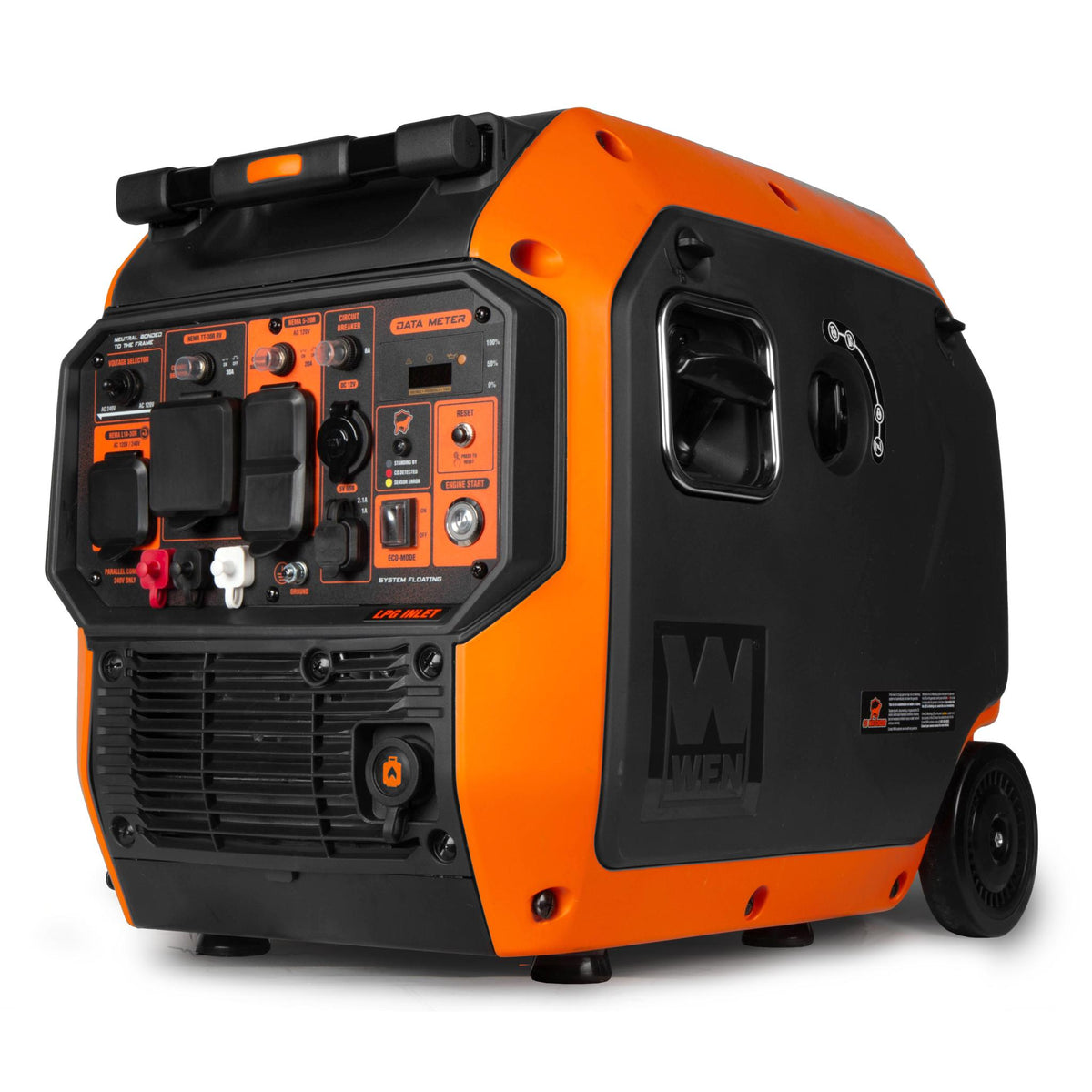

Also do I need a chargeverter to use my generator to charge the batteries? And if so, could I possibly just use the chargers that came with them connected to my generator? Would I have to disconnect them completely from the inverter if so? Sorry if those are stupid questions.
EG4 recommends using generators with THD under 5%; higher THD can cause problems. Chargerverter will clean "dirty" power. So, depends on which generator you have.
You can maybe by a 240v generator that has <5%THD for what the chargeverter costs these days.
I have a nexpow yh2200i
It is an inverter generator
I cannot find an exact number for the THD percent but google says most generator inverters are like 3%?
That nepow is 120v, I think it will work to charge 6000xp if hooked up to a specific input leg. Have tried that yet so cant say.
I got this one, says 1.2% THD, havent connected to my 6000xp yet been using with other things.
