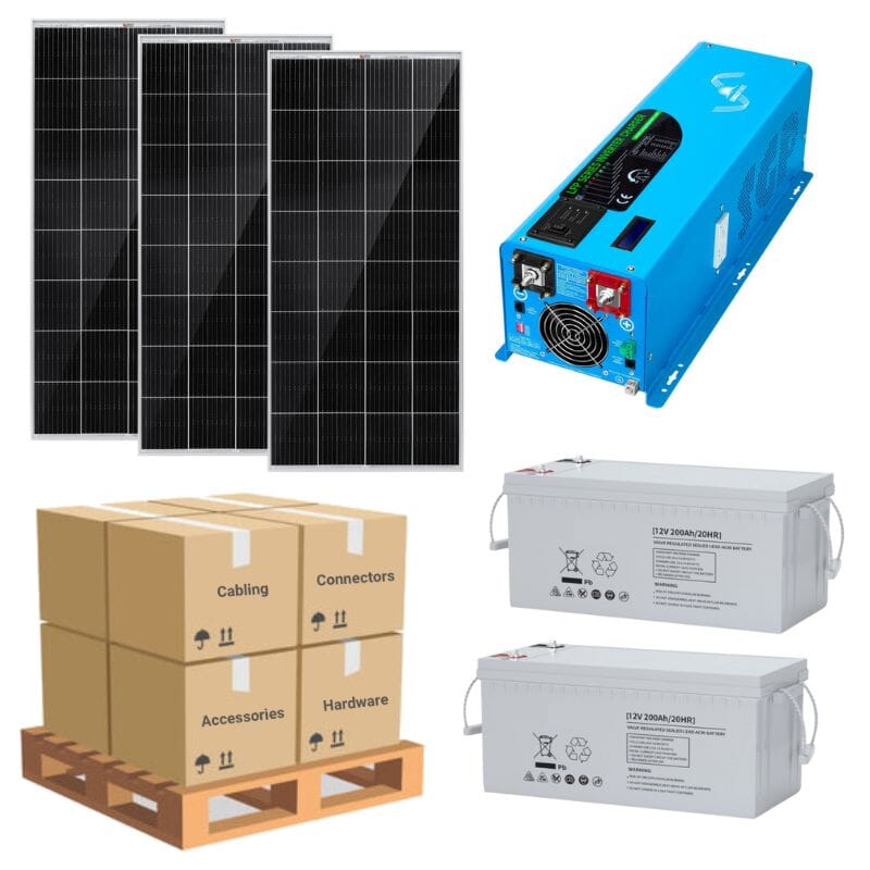

...solar will be my main source of power. I’ll be living in the RV for atleast a year. Still thinking about this system below. Unless anyone can think of a better value for the money.
This system is essentially the same, though only half the battery capacity, but you can buy a lot more battery for the $2,000 it saves you compared to the shopsolarkits product you're considering:
The inverter and MPPT charge controller are in one box, so there's less wiring to deal with. It is a 24v system, though, so it won't directly power your RV 12v system - there are advantages to sticking with 12v, and at this level of power and storage it's a coin flip - you could choose a 12v system such as this one:
And power your RV appliances and lighting directly from the batteries, integrating the solar system into the RV power system. This way you'll only have to deal with 120v and 12v, whereas with a 24 or 48v system you're adding another different voltage standard into the two already onboard, and you will always be running a 12v converter to keep the 12v system alive for basic RV energy.
Sticking with 12v means it'll be easier to sell the RV with the solar system, but it also means you're limiting your expansion of the system - as you consider going above 3kw of AC output, you'll start to find 12v systems are less efficient and less common than 24v and 48v. On the other hand, 24v is not a great place to settle at either.
Were I in your shoes, I'd consider doing a 12v install, and then I'd build a small workshop with the beginnings of a 48v system that would get me started building the house.

That $5K kit isn't a particularly good value. What they're not telling you is that simply having the inverter powered on will consume 25% of your battery bank's capacity and about 300W of the array (in good solar conditions, far more in bad) - that's if you use no loads whatsoever. The only way to avoid that loss is to turn the inverter off thereby losing all AC power.
As it has been pointed out, Winter performance of solar is often atrocious.
